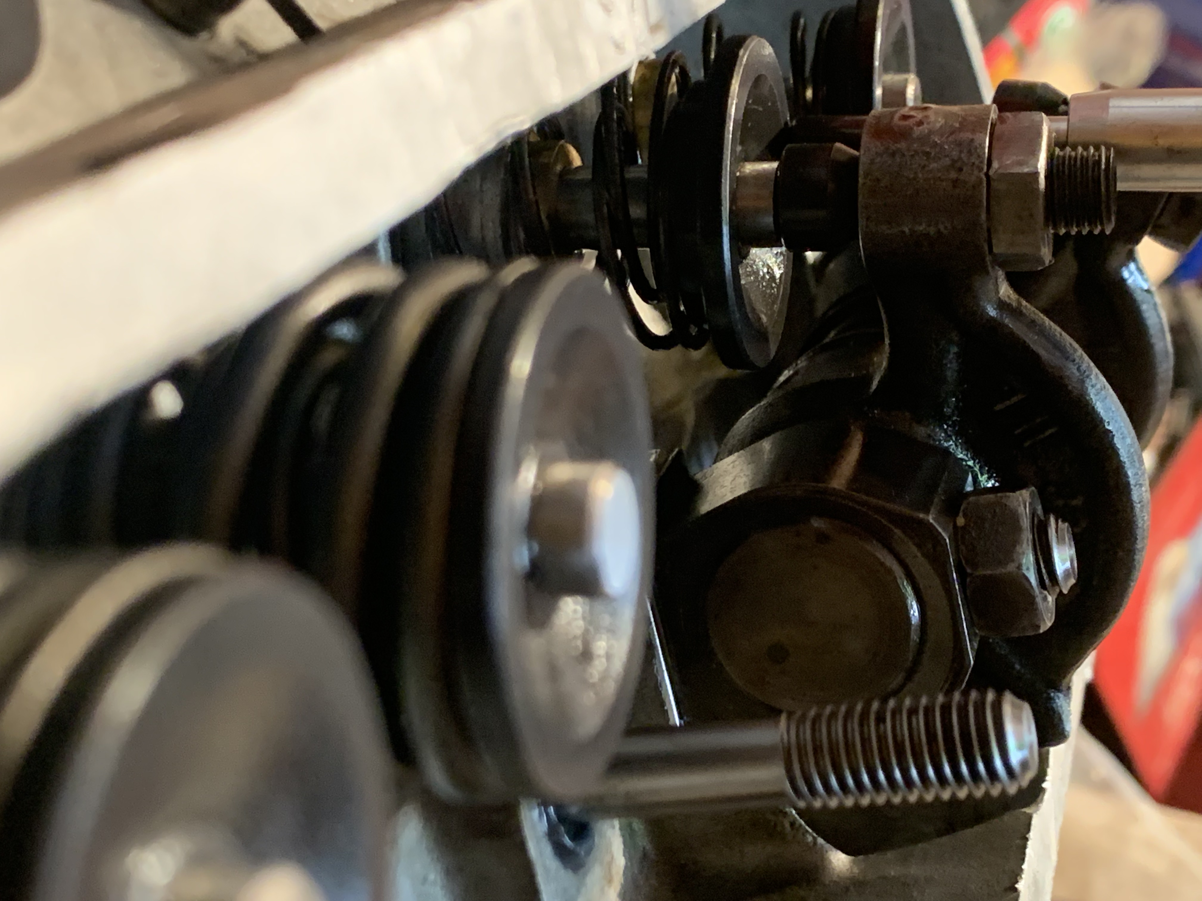

rfinegan   Add new valve train studs tonight and getting the ...   Apr 25 2021, 04:03 PM
rfinegan   and test springs added The test seings are from t...   Apr 27 2021, 06:21 AM
rfinegan   here is the first swing at setting the rocker geom...   Apr 27 2021, 06:23 AM
