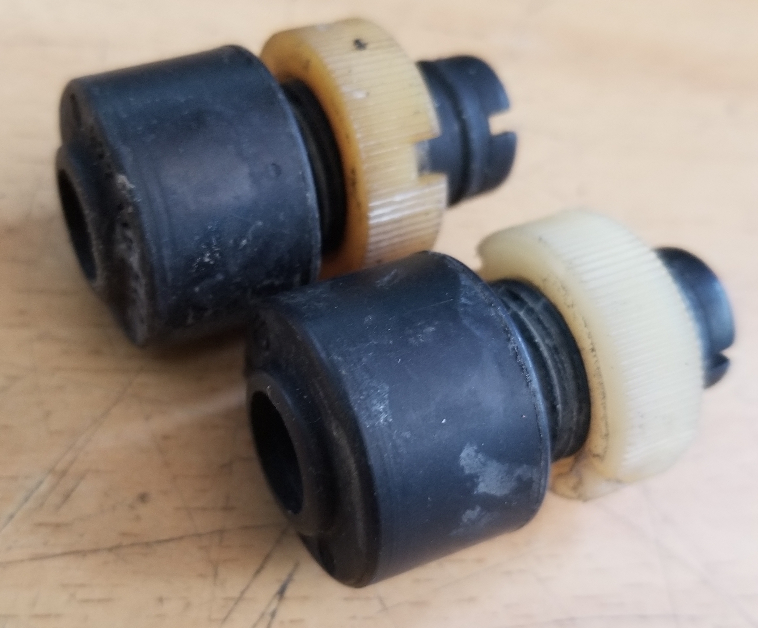

What would it take to get one of our vendors to make these?
022115542 - crank case valve
Surprisingly critical part for proper operation on 72-74 djet cars, not just for crank case venting but has a large impact on idle control and how d-jet runs. Supposed to be a regular maintenance/replacement item as well yet they haven't been available for close to 20 years. Struggling to find any that don't result in some sort of idle control issue these days.
Less critical is the associated nut 022115544
@Mikey914 @UROpartsman or anyone else want to bite?

Hi there,
Any news on this ? No idea if mine is properly working or not but interested in replacing. Have high idle (12/1300 rpm) and can't get it lower. When I block the line from the pcv valve to the plenum then the idle drops to 950 rpm
thks
Dax

I have several used ones i have cleaned. I will check the operation.

Here are two that are cleaned and tested. Asking $15 plus shipping.
