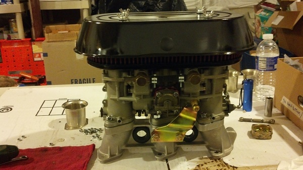

What kind of induction on the 3.0
Luke M
post May 19 2018, 05:20 PM
Posts: 1,608
Joined: 8-February 05
From: WNY
Member No.: 3,574
QUOTE(mepstein @ May 19 2018, 01:17 PM) *
Weber 40 IDA's with PMO manifolds.

QUOTE(Luke M @ May 19 2018, 04:20 PM) *
Looking good! What cam's are you running?
I had my 3.0 with DC19 cams, weber 40's, 1 1/2" headers, re-curved dizzy for carbs and a good flowing muffler. Man it was a lot of fun. I was on a race track with a 81' 911 on slicks and I lapped him after about 10 minutes...
Since you have new pistons you can probably do even better cams...
Yes, we installed different cams. They should be fine for a street car. I believe Mark Henry is running the same cams in his 3.0 as well. Web Cam, grind # 120/104 , Part # 05-261. It should go down the road just fine.. (IMG:style_emoticons/default/driving.gif)
