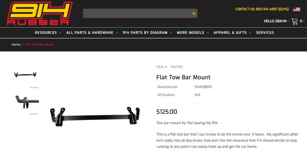

My BB does not have a front tow hook or loop, evidently it was sacrificed when the A/C was installed in 74. I would really like to put a ring on the front somewhere and the front subframe mounting point seems to be a great spot for this.
I've seen pictures of 914 track cars with a loop at that spot. anyone out there know where to source one of these? And then, can I just remove the subframe bolts to mount the ring without the torsion bar ruining the day? |

We have a tow bar may help. It will offer more lateral support and more area to hook onto.
$125 comes with mounting hardware We made it to work with the LE air dam Made from 3/8" steel plate Attached thumbnail(s) |
