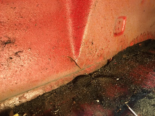

Now back to the main program...
Removing the carpet on the driver's side long, I noticed the classic crack on the hand brake area. The car currently has a Brad Mayer stiffening kit on the outside.
What is the recommended method to fix this? Simply weld up, cut the area and replace with fresh metal, weld and double up with a extra layer? (IMG:style_emoticons/default/confused24.gif)
