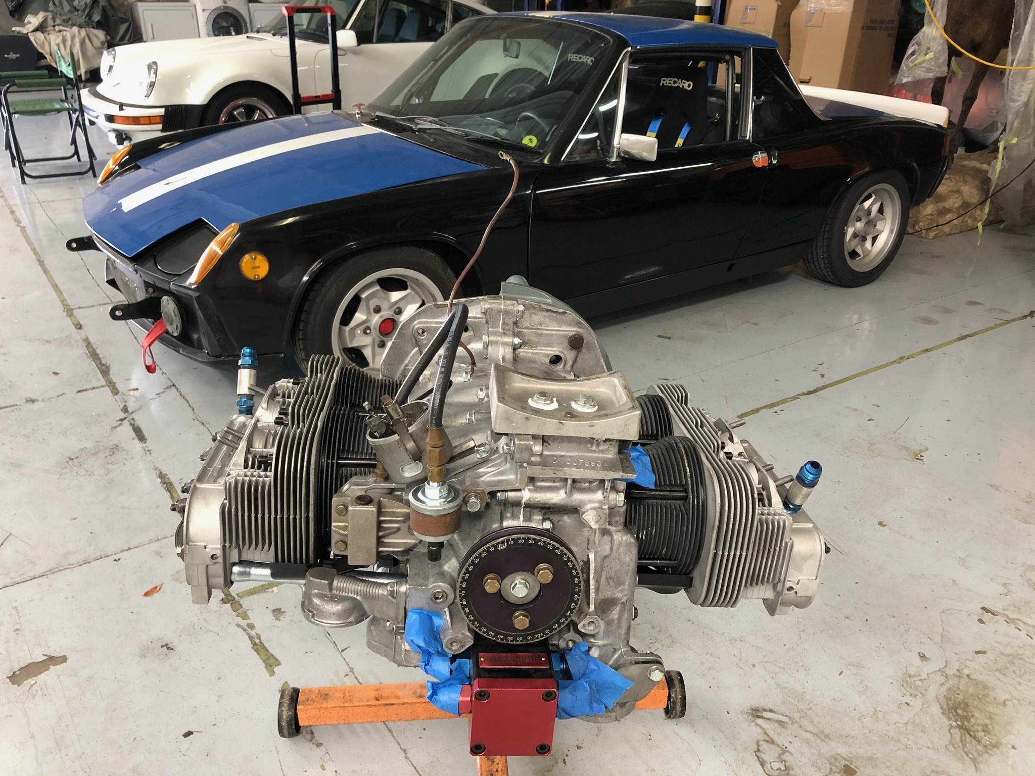

Still have the 4, finally got my new FAT build back. According to the builder, this is what 180 horses looks like...
(IMG:style_emoticons/default/idea.gif) This car is so fun and lightweight, I’m going to have a hard time putting it up for sale...
