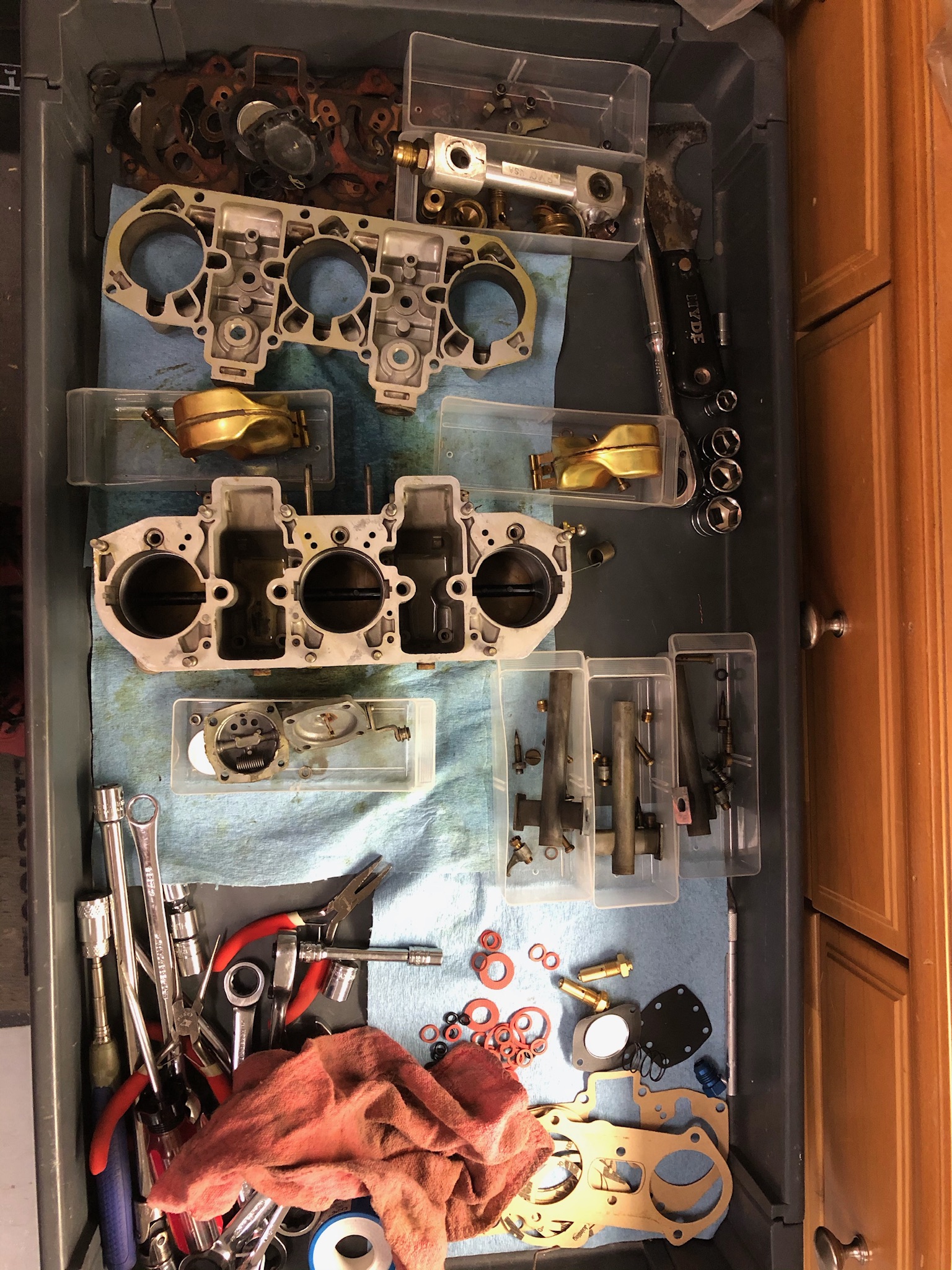

Thanks, I ended up, rebuilding the carbs, glad I did as some of the gaskets were ready to start leaking. It also gave me some piece of mind that gaskets were not the culprit for my current tuning issues.
I was still getting spits and misses, worse than before, so I attached my lm2 data logger and pulled spark plugs. She was running pig rich across the board. PO had notes about finally getting the carbs dialed in, so I was trusting his base settings, my gut kept telling me everything was too big...
Venturis: 42
Main jets 170
Idle jets 55
Emulsion tubes F7
I finally got the balls to change main jets to 160 and idles to 50, wow what a difference! No more popping and missing, still rich, but no flat spots where the motor was getting bogged by fuel, moving closer to the sweet spot.
I started having issues with my lm2, so I installed a permanent afr gauge in the cockpit. No data logging, but I can start fine tuning now... anyone know any good carb tuners?

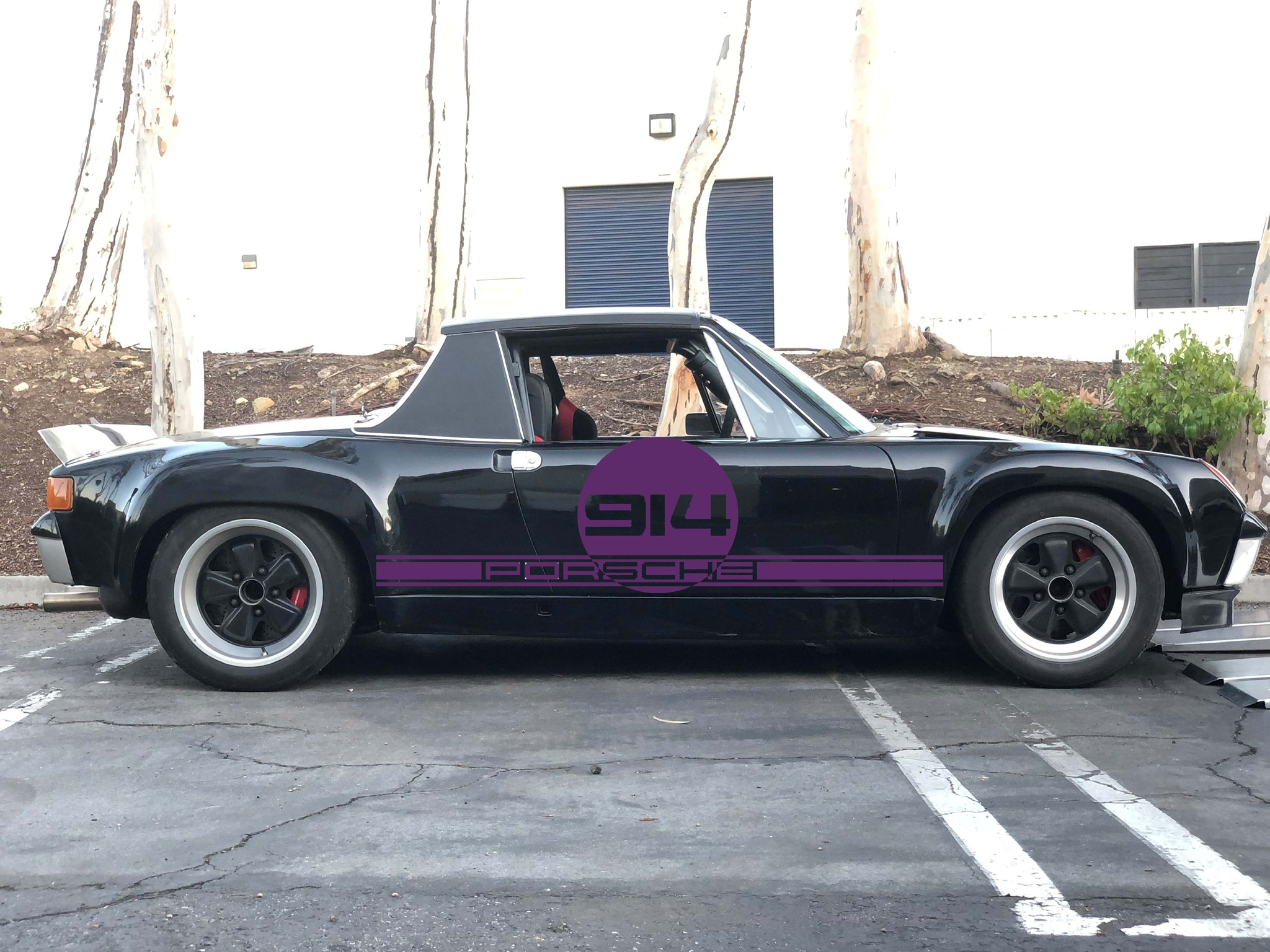

My girls wanted to see some purple on the car so I’m playing with livery schemes on photoshop.
