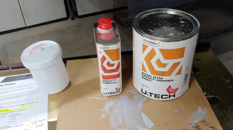

Oh what a PIA it has been getting all of this sand out of the chassis. We did get to spray a door in epoxy on Tues. Then the rain moved in and that was it for the day. We will do some welding on the chassis either today or tmrw. The blast exposed several areas that need some minor attention. We are gonna get all of the smaller parts in epoxy and leave the chassis for last.
