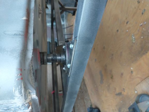

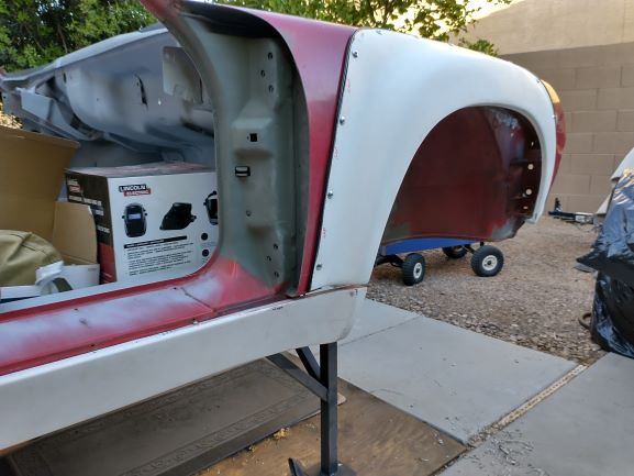

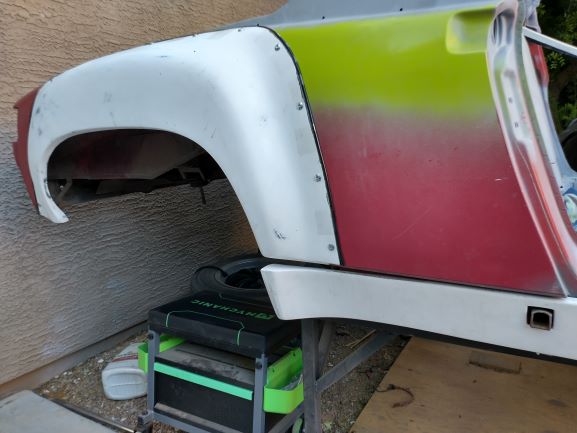

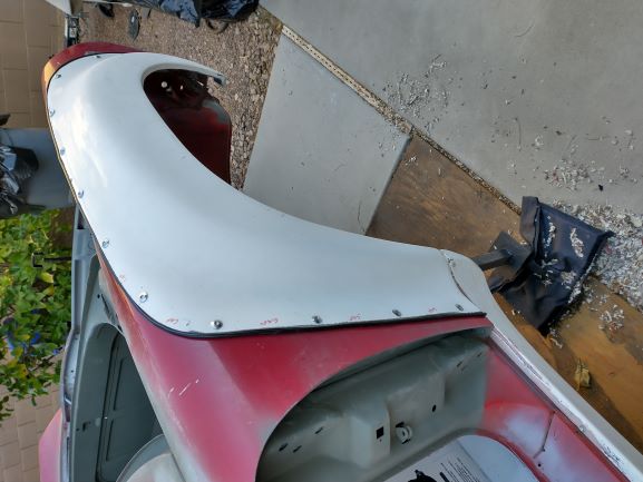

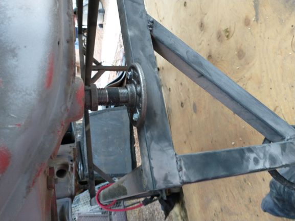

I saw a great idea in "9146C's" thread to lift the chassis up off the body dolly a few inches, so I copied his idea after a quick trip to Lowes for the parts. The front jacking "donuts" sit inside the rears (who noticed!), so I had to add some 1/8" plate to locate them in the proper spot. With a bit of assistance from my son, and some 4x4's laying on the QuickJack rails, we had success!
I was going to use "fender nuts" to give me a bit of wiggle room for flare alignment, but in the end it did not really help much - will be going back to my original rivnet/nutsert mounting idea.

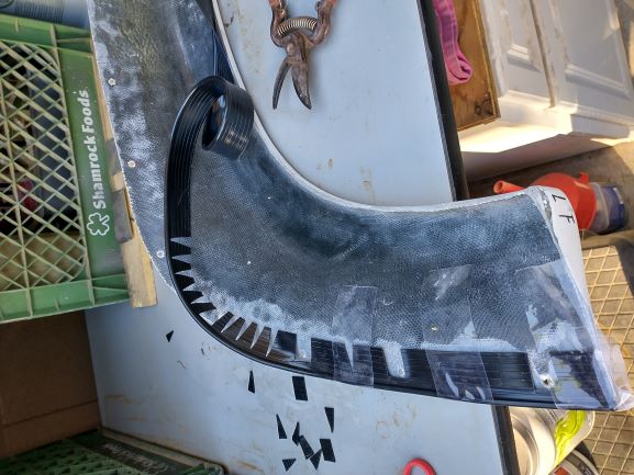

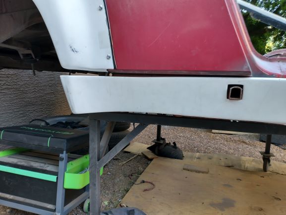

Received my VW fender beading and set about getting it trimmed to fit and clear the mounting bolts, etc.
I believe once the flares are painted body color, and I figure out how to hold the beading in place on the back of the flares, this is going to look pretty decent.

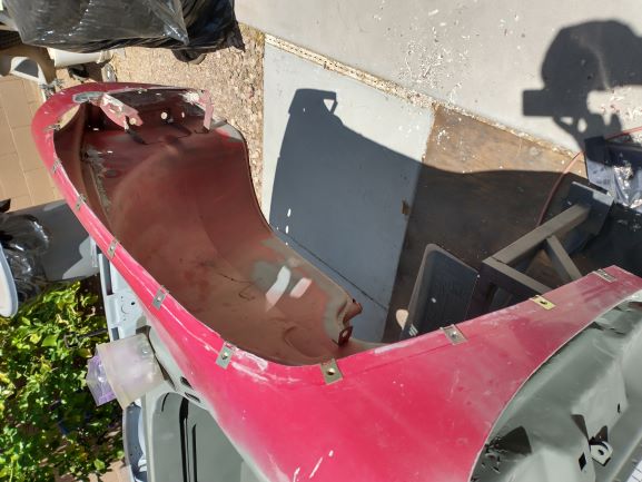

I cut out some metal strips to rivet to the bottom of the fiberglass rockers - this was how James Patrick @ PMS said they mount the bottom of the rockers. A bit annoying, to say the least that you have to create your own mounts for $300 fiberglass rockers! (IMG:style_emoticons/default/hissyfit.gif) I may end up going with the weld-on ends eventually since the original metal rockers I have are in good shape. They do line up reasonably well once you get the lower mounts attached.

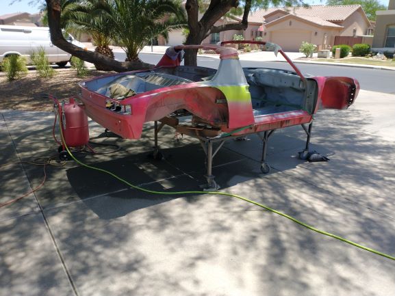

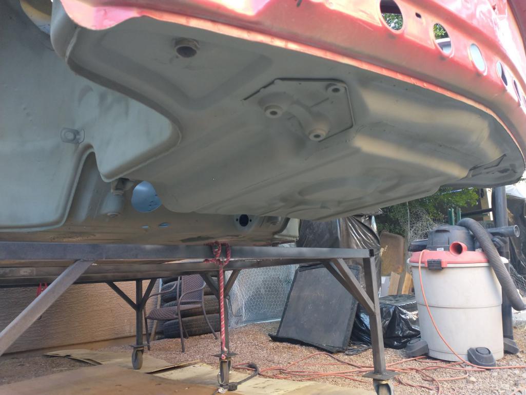

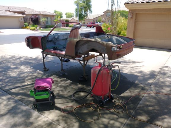

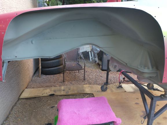

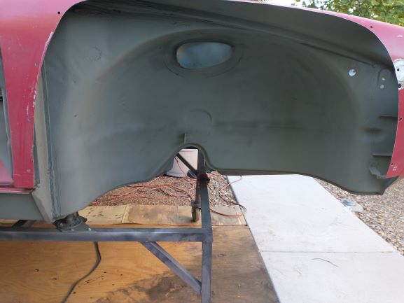

Next up was getting the fender wells and bottom media blasted and ready for the Raptor bed liner coating. Got sick of cleaning up media off the driveway really quick! I was able to reuse quite a bit of media by sifting it into a 5 gallon bucket, then sifting it again as it went into the blaster. I can't believe how much of that crap got into my shoes though - it was under my insoles! (IMG:style_emoticons/default/wacko.gif)
I sprayed and wiped down the fender wells and the bottom with degreaser just to be on the safe side. There was quite a bit of grease on the passengers side near the rear axle that I had to scrape off before blasting. Grease does not like to come off by blasting - too soft I guess! Grease also got up into the passengers side rear shock mount - that was way too much fun to clean out! Looking pretty decent at this point - still need to finish priming the bottom - ran out of juice just behind where the steering rack mounts... (IMG:style_emoticons/default/yellowsleep[1].gif)
