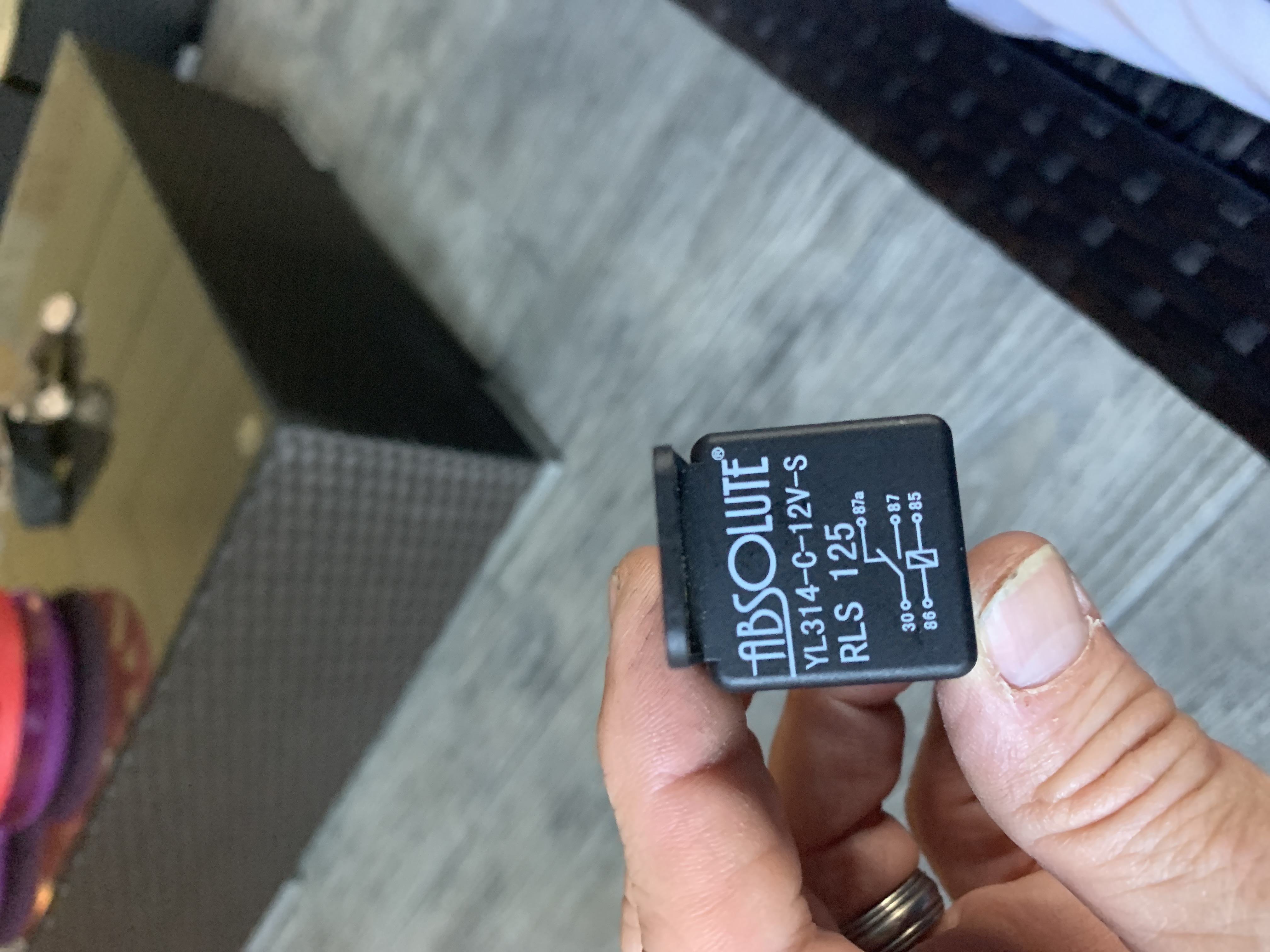

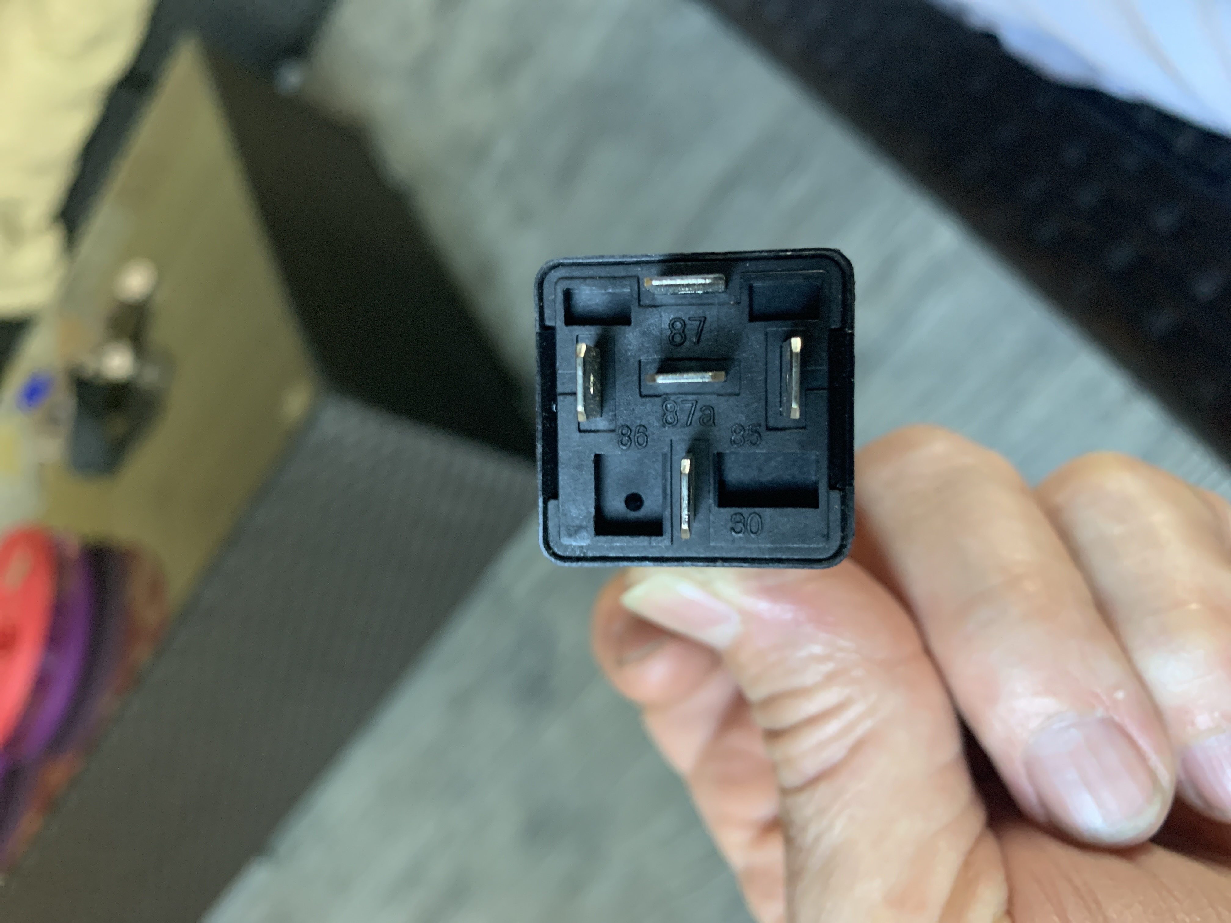

DRPHIL914
post Apr 25 2021, 04:53 PM
Dr. Phil
Posts: 5,971
Joined: 9-December 09
From: Kennesaw, GA
Member No.: 11,106
QUOTE(rothaus @ Feb 10 2019, 07:04 PM) *
Ok, here is my recommended wire diagram for the washer switch installation. However, there are other ways to wire the switch.
(IMG:http://www.914world.com/bbs2/uploads_offsite/c2.staticflickr.com-12404-1549839863.1.jpg)
Hope this will help.
Thanks
Engelbert
since several other members are dealing with this issue again , i am bringing it up again to ask if this relay will work? only difference i see is it has a 87 & 87b. that and the 85&86 are unopposed positions.
Warren914
post Jun 8 2021, 09:22 AM
Posts: 93
Joined: 26-February 21
From: Nova Scotia
Member No.: 25,265
The only issue I see using that relay is the potential of the relay having a built in diode across the coil. If there's no diode you're good to go.
Adding a reverse bias diode will reduce sparking across the switch when the relay is released, potentially eliminating another problem down the road.
[/quote]
