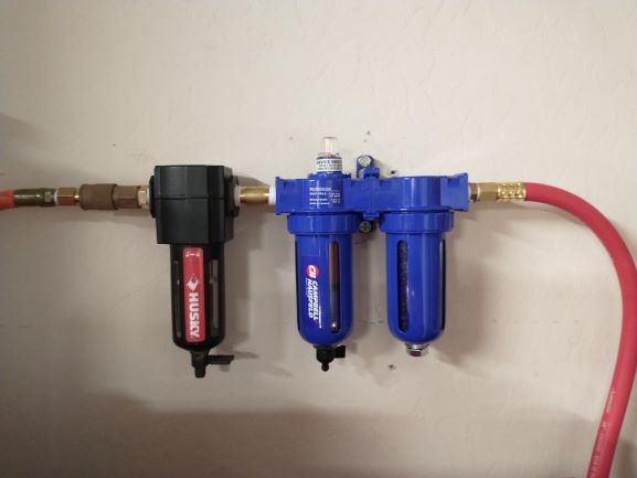

Finally got my filter/dryer delivered and installed. Getting the right adapters together was a PITA, of course! Hopefully, this keeps the compressed air clean enough for spraying the Raptor liner, and maybe paint one of these days! (IMG:style_emoticons/default/idea.gif)
