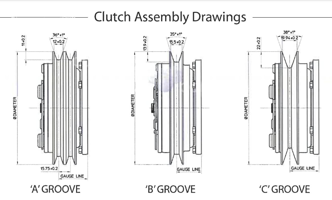

I need to match the engine pulley to the clutch pulley on the compressor.
Anyone with an engine pulley close by to take measurements?
What is the pulley diamater?
What type belt does it require? A, B, or C?
Considering a Sanden SD7L13 compressor.

Warren914   I need to match the engine pulley to the clutch pu...   Jun 13 2021, 05:32 AM
Mark Henry   I'll look for the pulley I have. I know for su...   Jun 13 2021, 06:16 AM
Mark Henry   This heavy steel pulley I have is for the old styl...   Jun 13 2021, 06:45 AM
Warren914   Dug out the York anchor. Big and heavy POS. Groov...   Jun 13 2021, 07:06 AM
