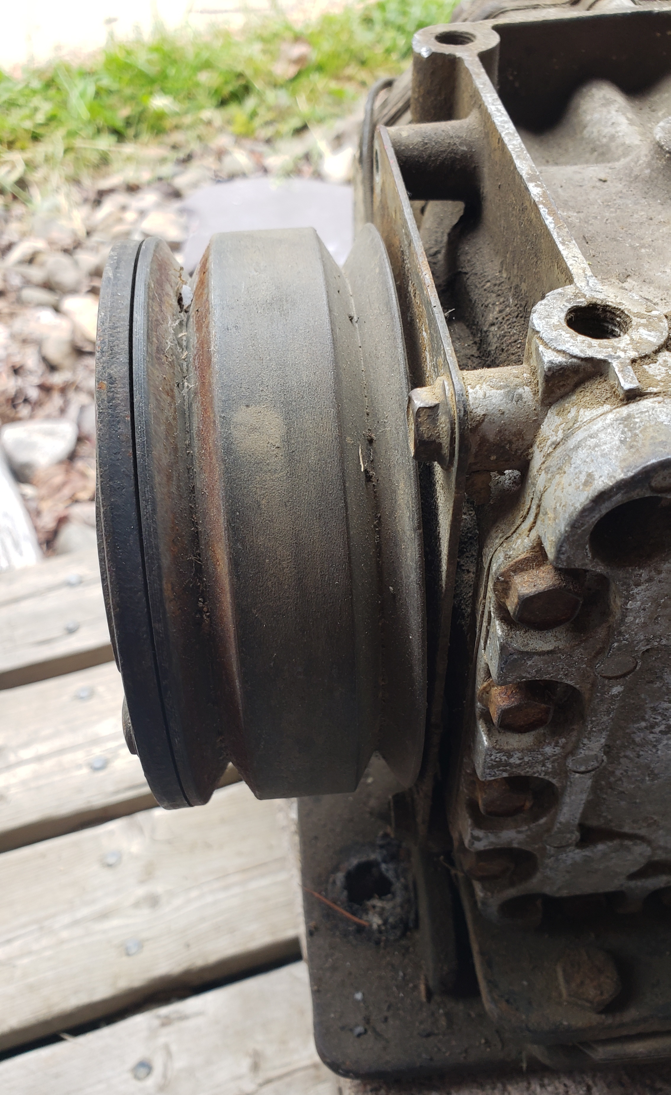

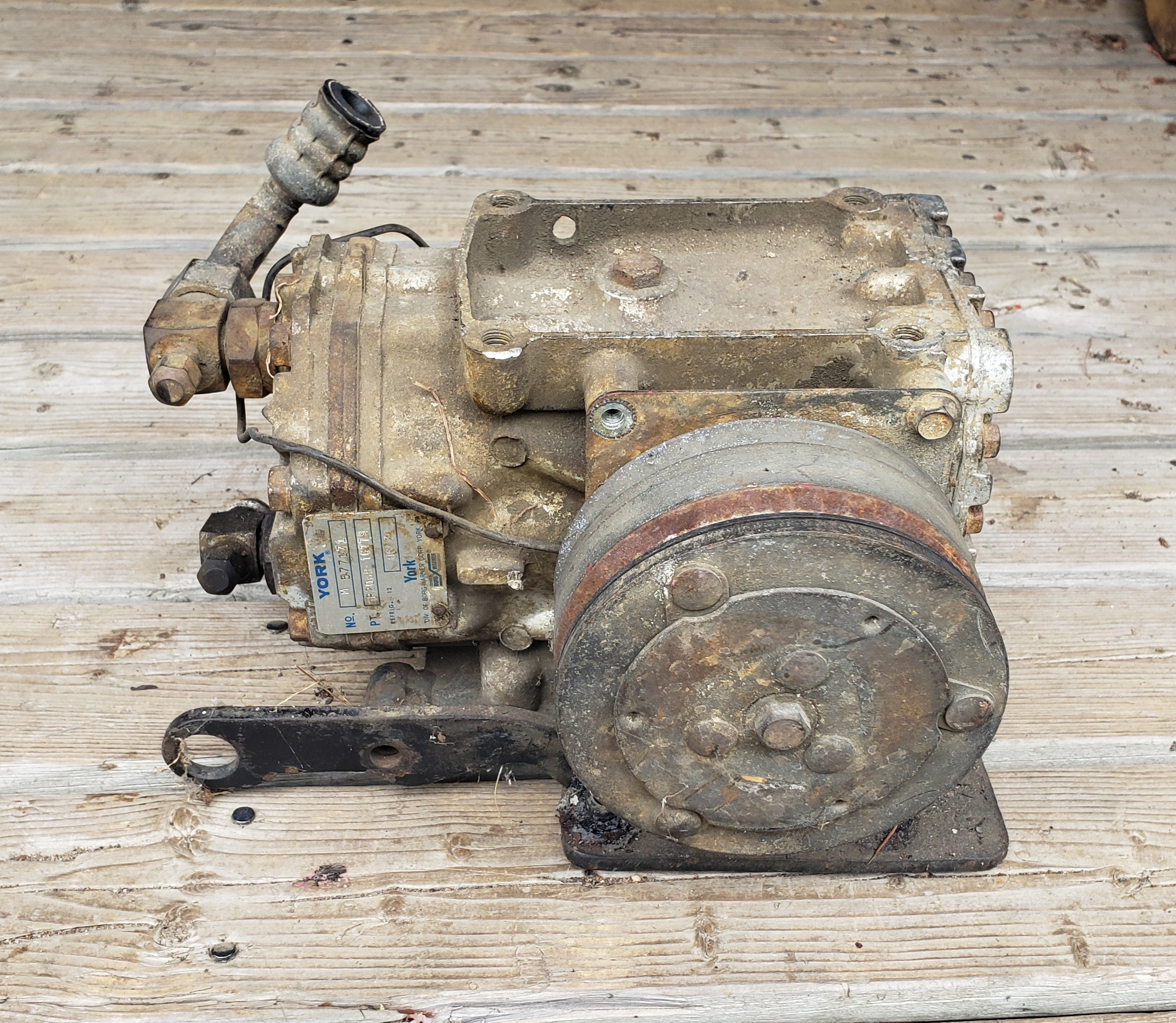

Dug out the York anchor. Big and heavy POS.
Grooves look to be same fit as the alternator belt.

Warren914   I need to match the engine pulley to the clutch pu...   Jun 13 2021, 05:32 AM
Mark Henry   I'll look for the pulley I have. I know for su...   Jun 13 2021, 06:16 AM
Mark Henry   This heavy steel pulley I have is for the old styl...   Jun 13 2021, 06:45 AM
Warren914   Dug out the York anchor. Big and heavy POS. Groov...   Jun 13 2021, 07:06 AM
