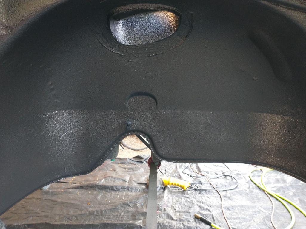

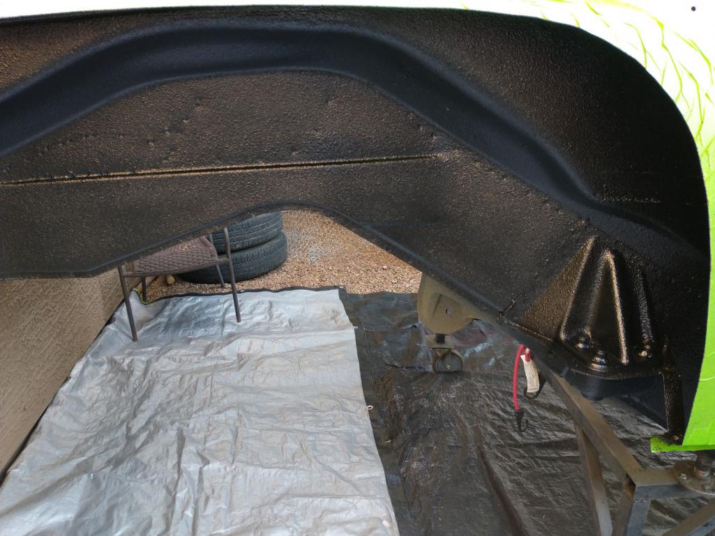

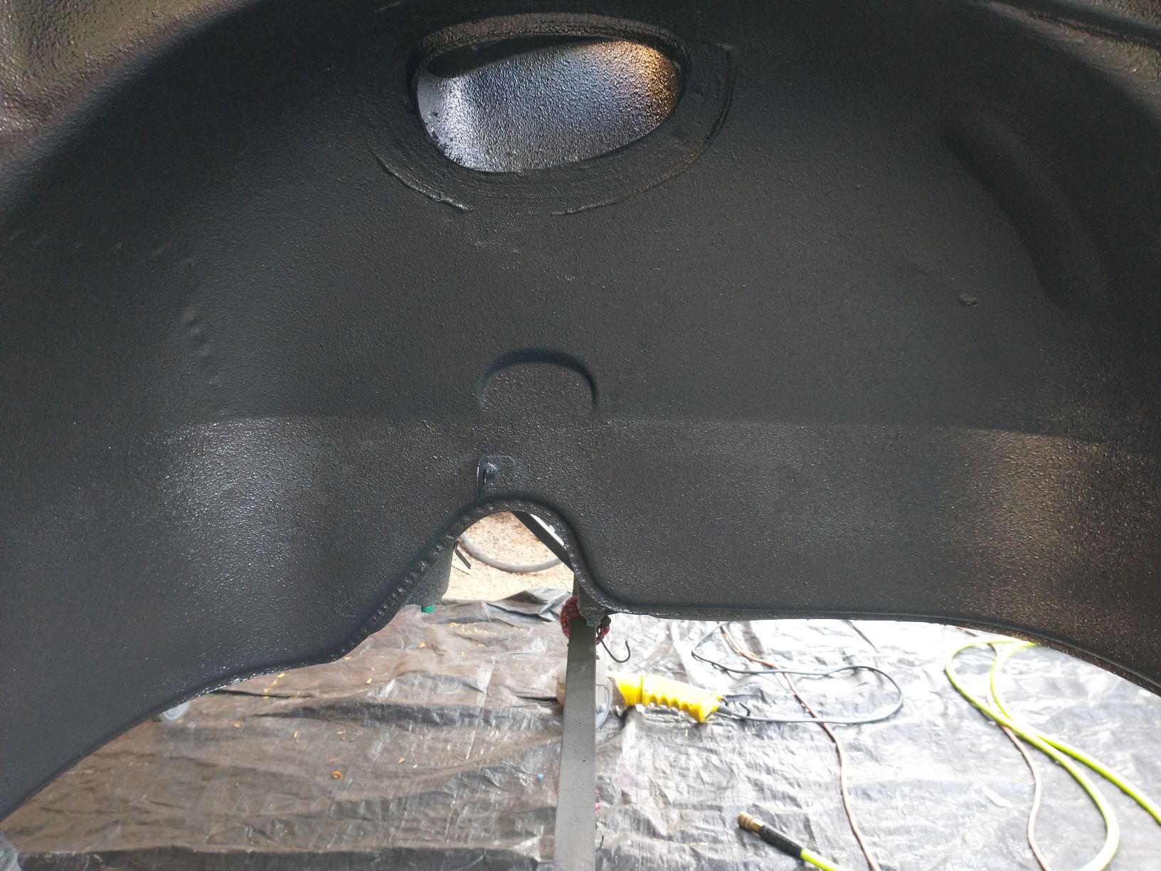

Started before 6am to try and spray at least one quart of Raptor liner on the fender wells before it got too hot. It was already about 85, and toasty with long sleeves, gloves, and respirator on! But, I got three fender wells, and the passenger rocker sprayed with Raptor. Super easy to spray, and the little bit left in the bottom of the jug was still liquid, so the heat did not affect the hardening time that I could tell. I think the flash time was super short though - was dry to the touch in no time! Came out rather well, I think! (IMG:style_emoticons/default/piratenanner.gif)
