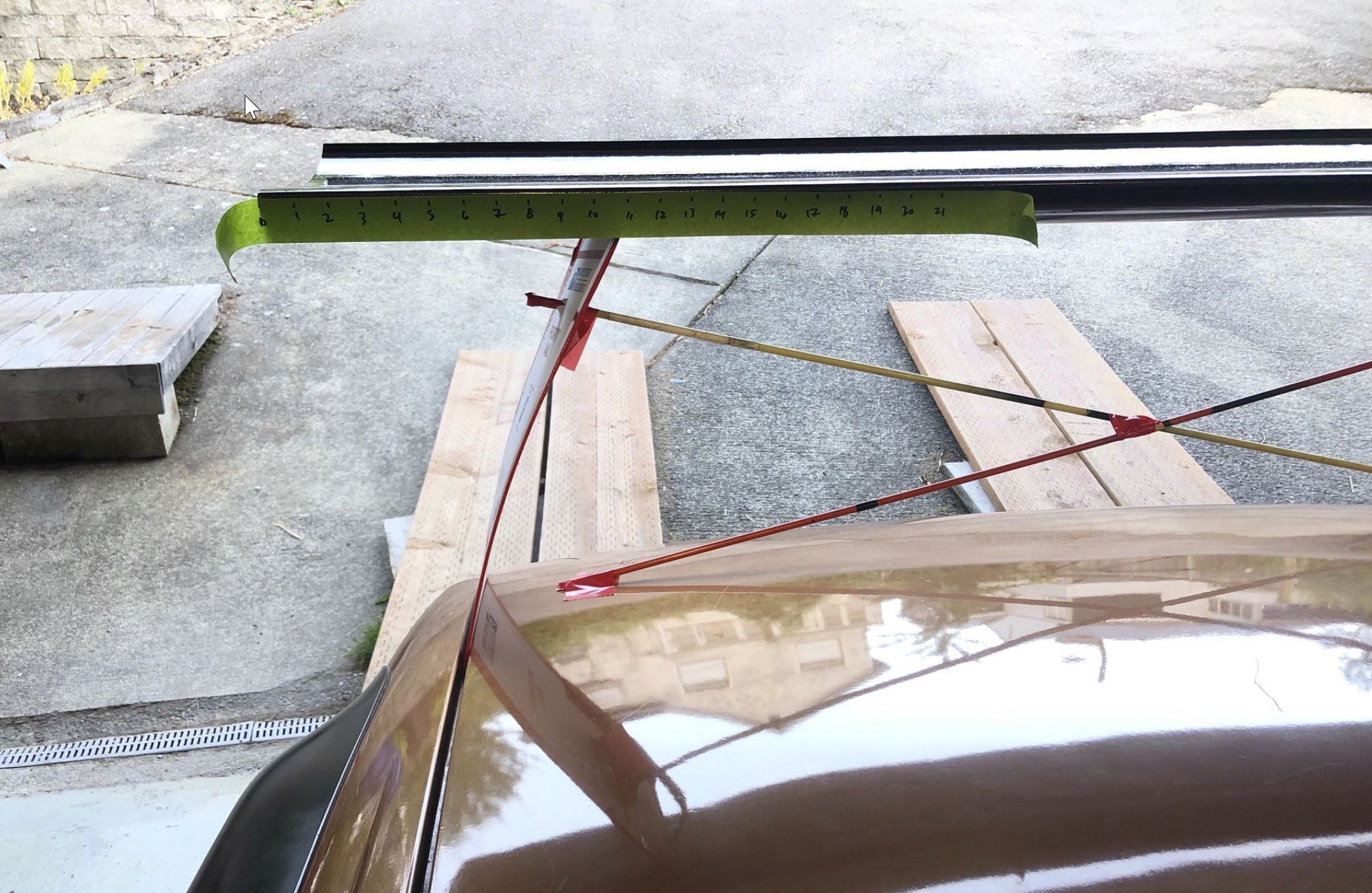

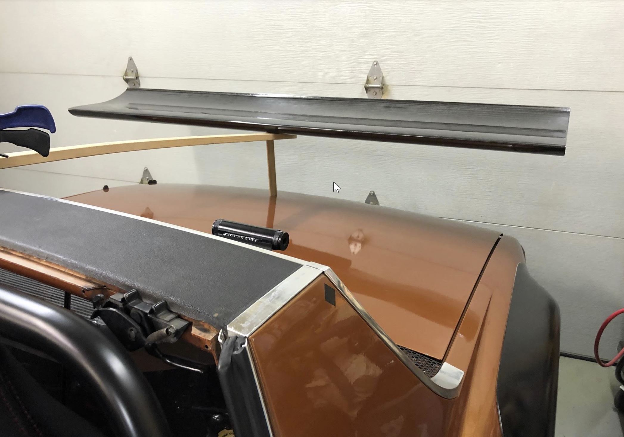

For a long time I had plans to build the wing. I knew I needed the downforce with the planned torque, and also the desire to carry boards, bikes, and maybe our kayaks. I have been custom roof racks or boxes for most of our cars.
I got distracted by making an even larger version of this for our 3.6 VR6 corrado racecar, but planned to use those lessons for improved aesthetics.
My goal was to make a big wing with a modern airfoil, designed around the speeds I want downforce, and I want adjustability, and potential the opportunity for tunable, passive AOA adjustment in the future. It is fixed for now, but have the adjustment if I get really bored in the future.
I had cores hot wire cut, installed a spar, and did a low vacuum operation by throttling a cheap vacuum pump I got to install some heat pumps.
After the wing was build I spent 6 months deciding how I was going to mount it, but mostly, where.
