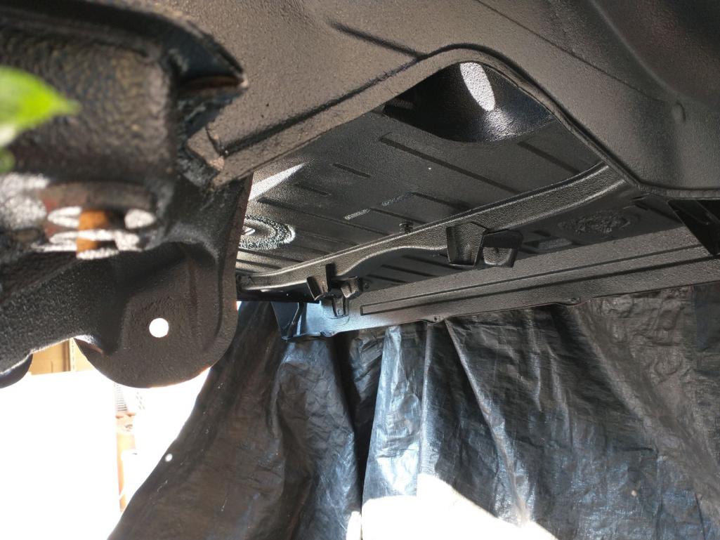

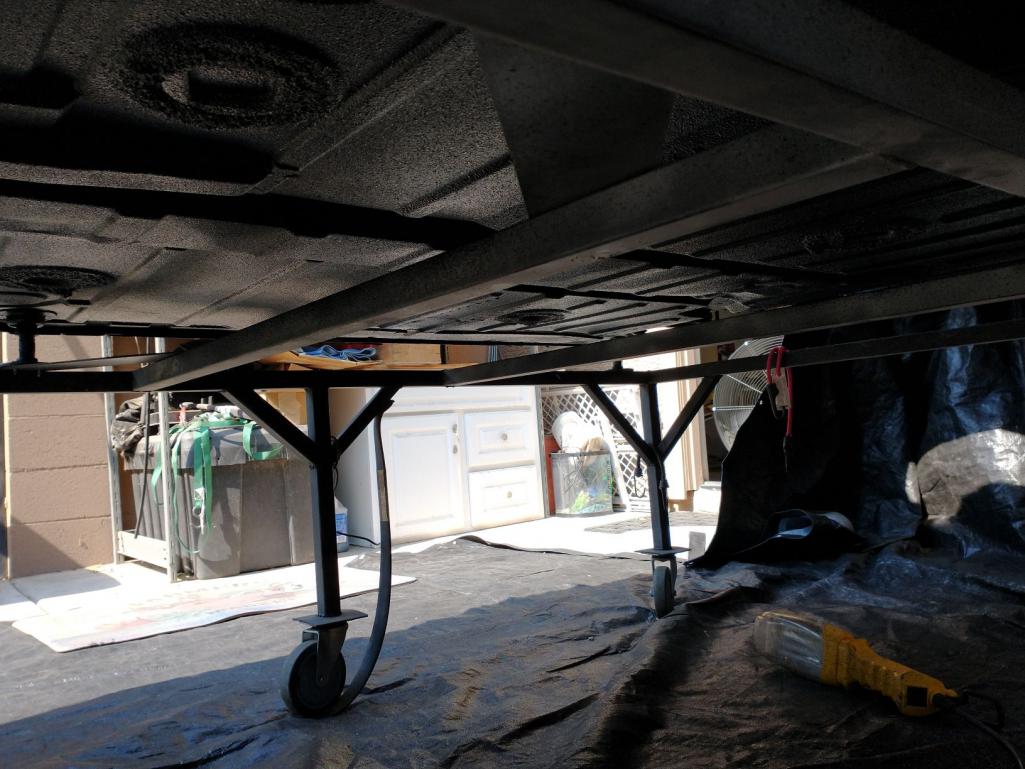

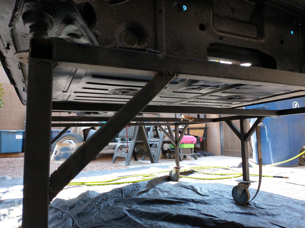

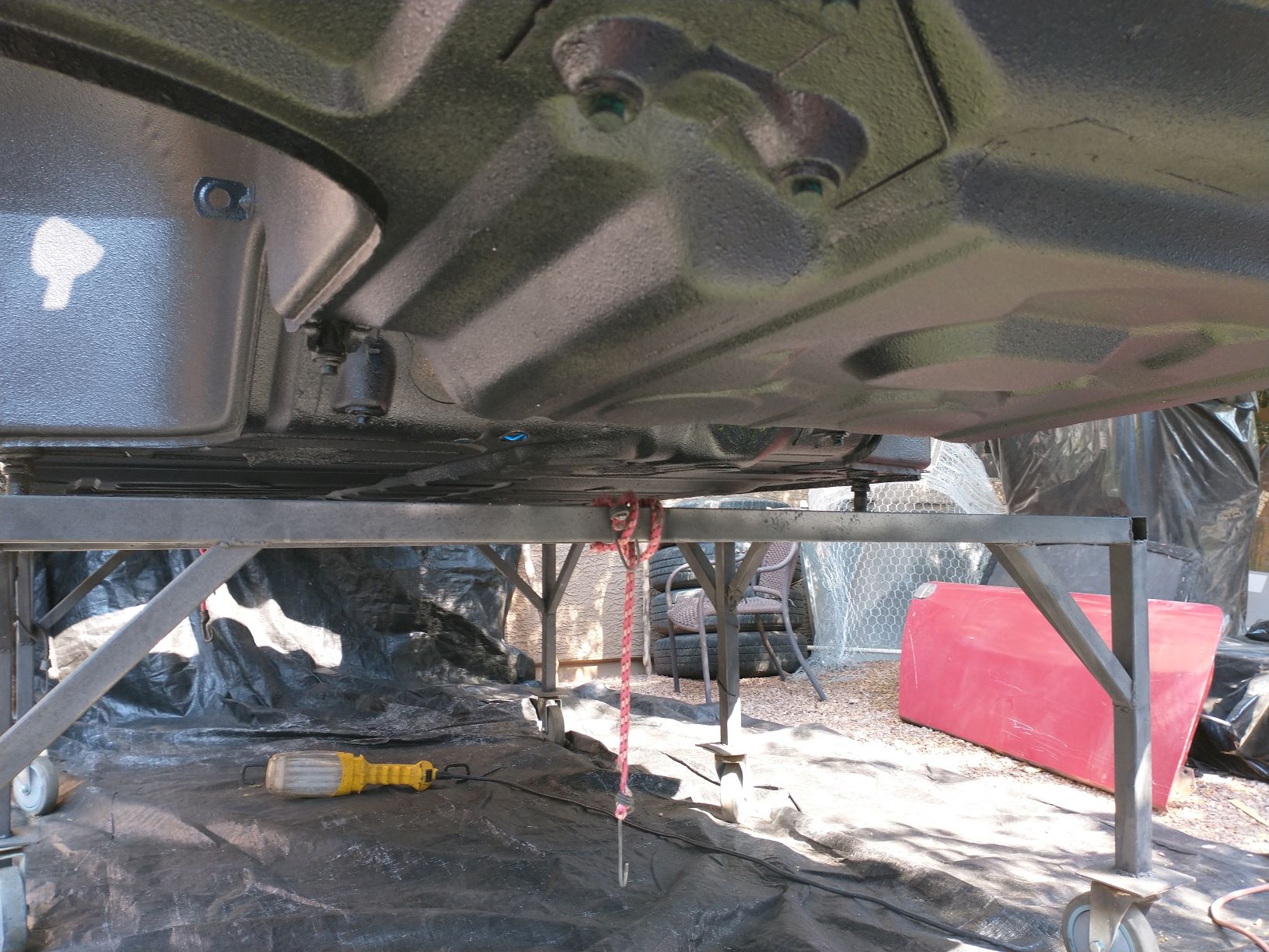

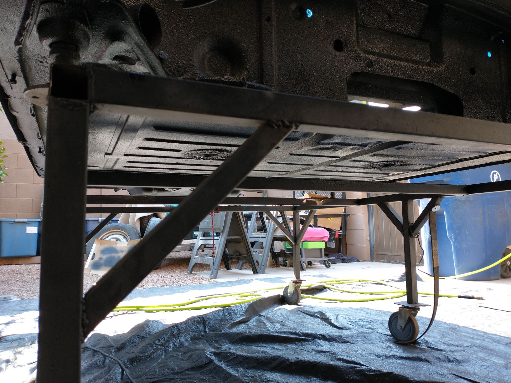

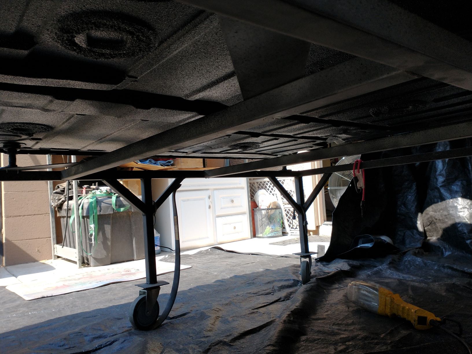

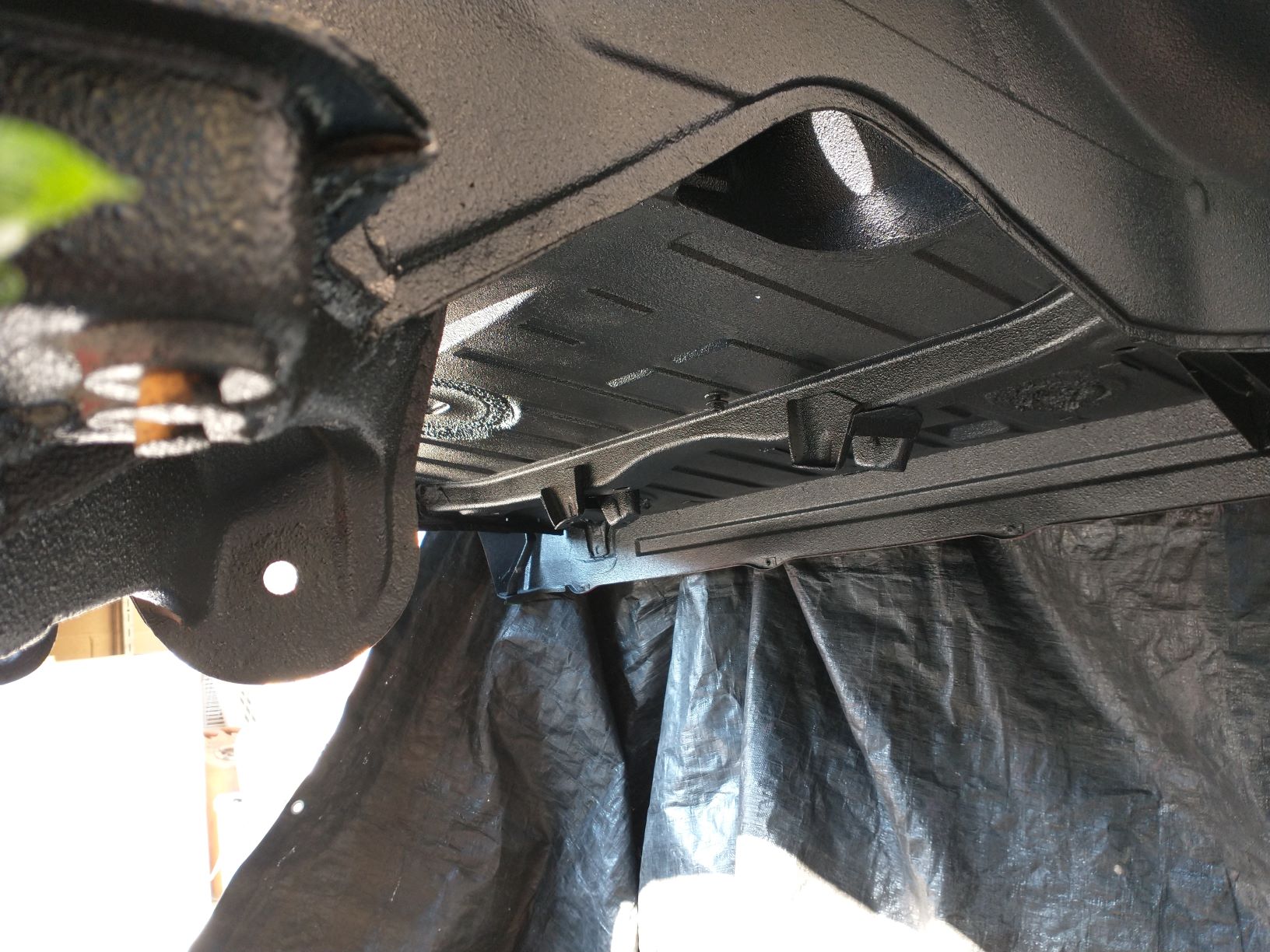

I've been spraying one quart each morning before it gets too hot. I got the bottom covered this morning, and I still have one quart left. There are a few spots that need touch up, but not too many. It's definitely a challenge to spray with the tub on a body dolly, but totally possible. The Raptor is crazy easy to spray - I'm not sure you can really mess it up! Wearing long sleeves, gloves, respirator, etc. in 90+ degree heat is not so easy...But, it does flash off/dry really quickly!
Attached ImageAttached Image
I really like how it came out! So much so, that I ordered a 2nd Raptor kit and plan to do the frunk, trunk, and inside. I may eventually scuff the Raptor and paint it body color in the frunk & trunk, but I really like the texture and durability it provides. It also seems cheaper/easier than lining areas with Dynamat.
