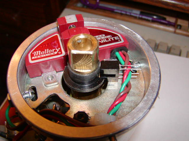

Here the wheel is mounted in my Mallory distributor....the sensor at the 3 o'clock position will be replaced by a smaller unit, I can make this one work, but at only a $1.50 a pop, it's not that big of a deal to get one that'll work easier......the distributor will have 2 sensors mounted 180° apart, this way the ECU will get the correct signals to fire off the injectors....
