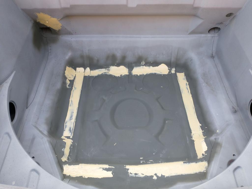

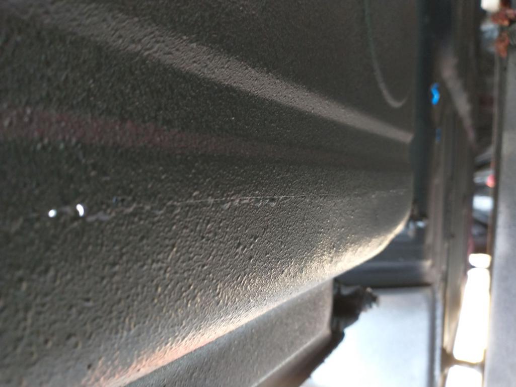

So, the Raptor coating did not hide my patches/repairs as much as I hoped for. Not sure if it's because of the sheen, or if I know where to look. Here's a couple examples where the patch/repair is a bit too easy to see:

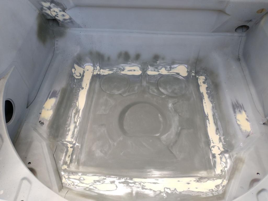

So, I ordered some body glaze and set about seeing if I could fill over and around my repairs so they are not quite so visible. I figured since I'm now working on the topside, I might as well make the effort to make things look better! (IMG:style_emoticons/default/idea.gif)
Most of the work was where I replaced the frunk floor...
My fingers are a bit tender after all the hand sanding to blend things in/feather the glaze out.

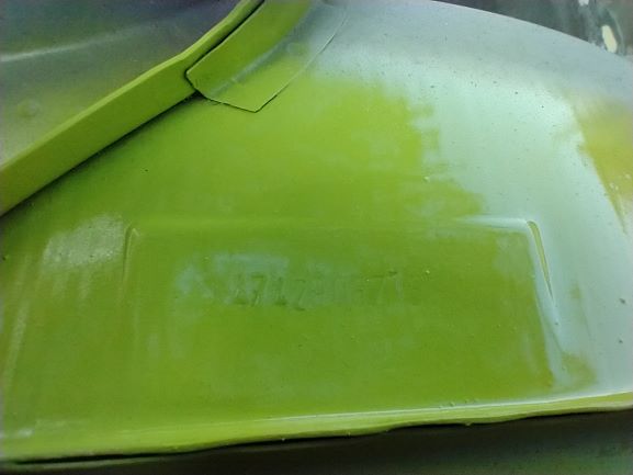

I went ahead and sprayed the VIN body color, and coated with clear. Does not look great, but decent enough for under the hood.
Now I just need to figure out how to mask off a clean rectangle over the VIN number so it does not get coated with Raptor and you can't read it anymore! (IMG:style_emoticons/default/blink.gif)
