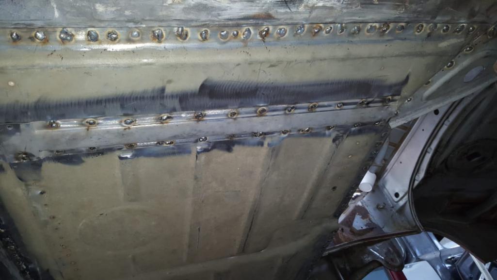

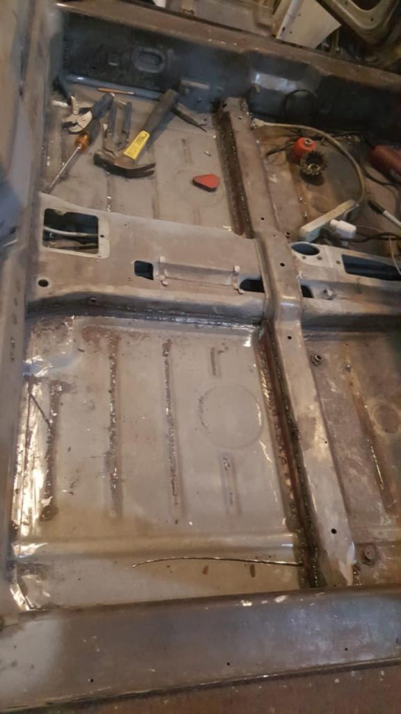

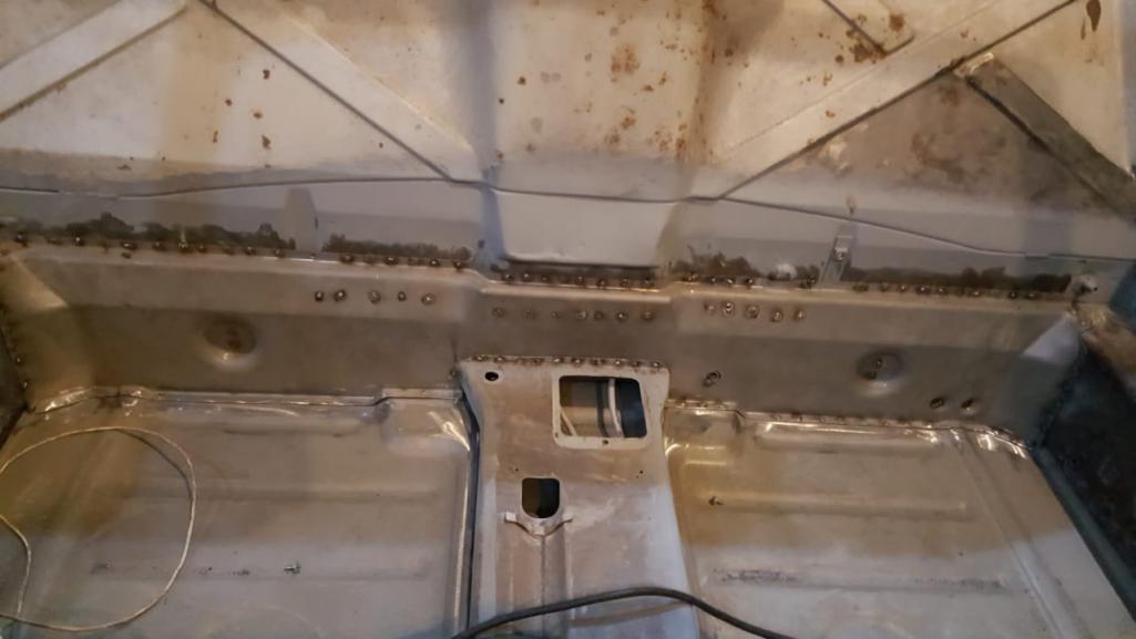

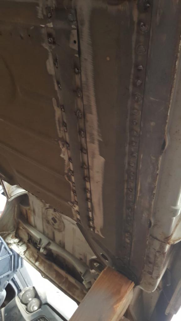

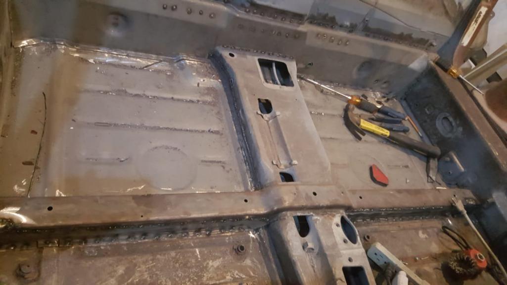

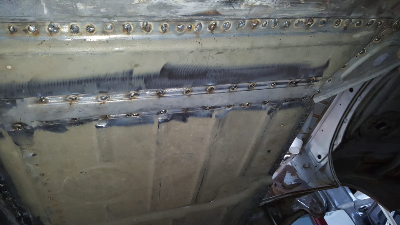

autopro   Even though the car was fairly rust free, the rear...   Jul 18 2021, 07:51 PM
autopro   At this point I was happy how everything was fitti...   Jul 19 2021, 12:08 PM
autopro   Here is the bracket installed and the installation...   Jul 19 2021, 12:15 PM
