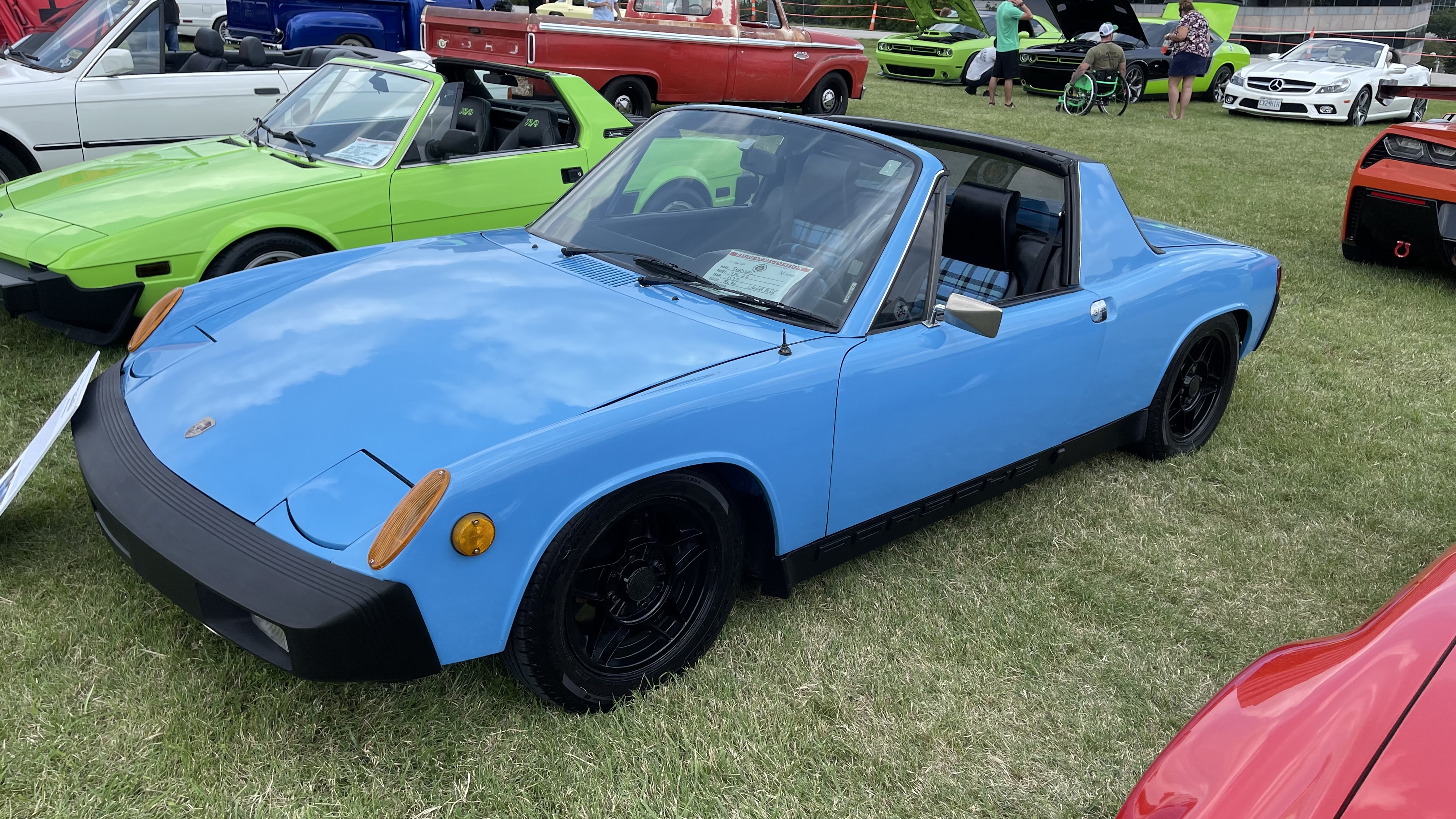

Thanks for asking - yes, I found receipts for a new set of 2.0 liter cylinders and pistons. Plus, a receipt for rehab of the original 2.0 heads. Apparently the prior owner decided to use a different case for strength when he rebuilt the engine. The speedometer is 150 mph also, further indicating the car was originally a 2.0 liter car.
Attached is from The Great Car Show in downtown KC yesterday.
