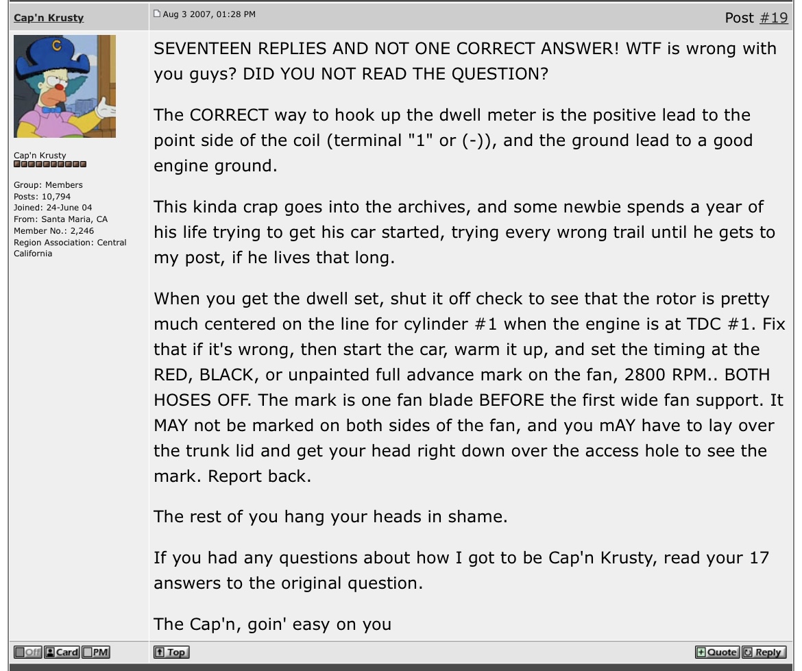

Cap'n Krusty
post Aug 3 2007, 02:28 PM
Cap'n Krusty
Posts: 10,794
Joined: 24-June 04
From: Santa Maria, CA
Member No.: 2,246
SEVENTEEN REPLIES AND NOT ONE CORRECT ANSWER! WTF is wrong with you guys? DID YOU NOT READ THE QUESTION?
The CORRECT way to hook up the dwell meter is the positive lead to the point side of the coil (terminal "1" or (-)), and the ground lead to a good engine ground.
This kinda crap goes into the archives, and some newbie spends a year of his life trying to get his car started, trying every wrong trail until he gets to my post, if he lives that long.
When you get the dwell set, shut it off check to see that the rotor is pretty much centered on the line for cylinder #1 when the engine is at TDC #1. Fix that if it's wrong, then start the car, warm it up, and set the timing at the RED, BLACK, or unpainted full advance mark on the fan, 2800 RPM.. BOTH HOSES OFF. The mark is one fan blade BEFORE the first wide fan support. It MAY not be marked on both sides of the fan, and you mAY have to lay over the trunk lid and get your head right down over the access hole to see the mark. Report back.
The rest of you hang your heads in shame.
