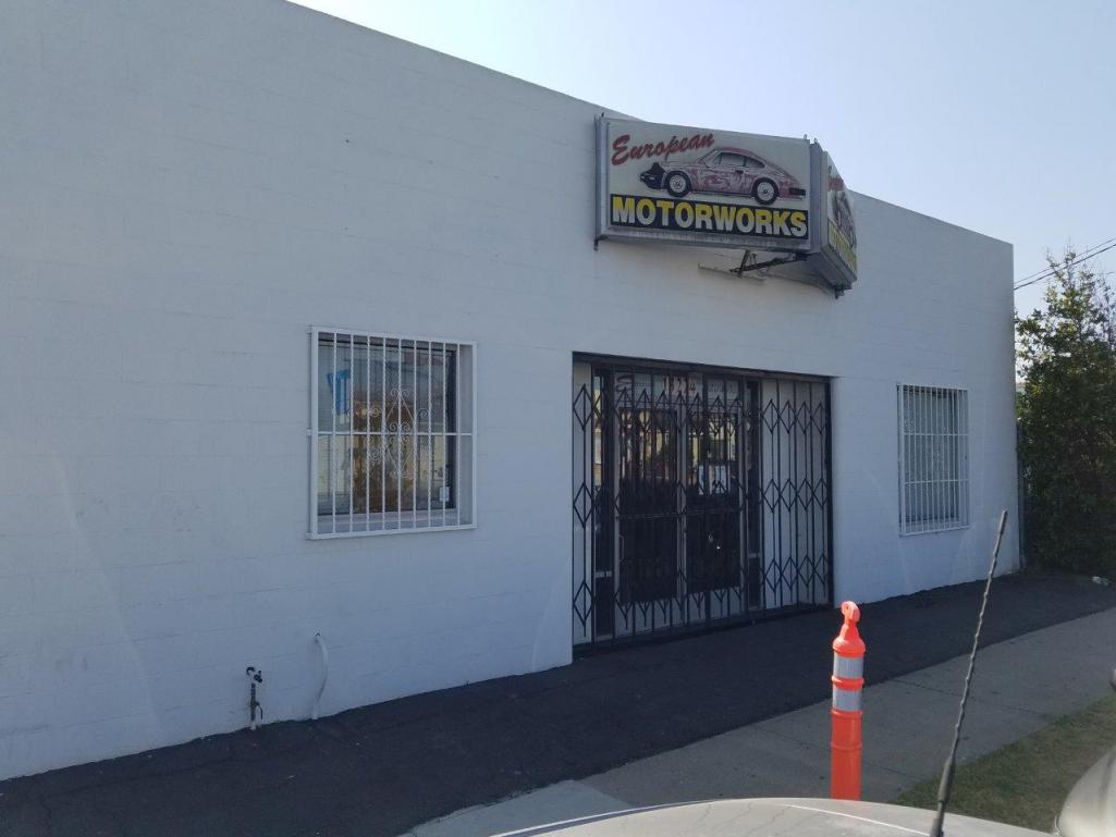

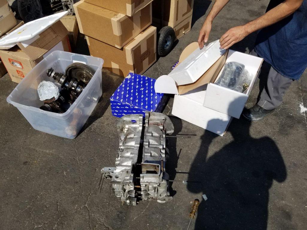

Last week I took my engine on a little trip to LA, some of you might recognize the place. It has been great working with them, Jorge and Carlos have been great to work with.

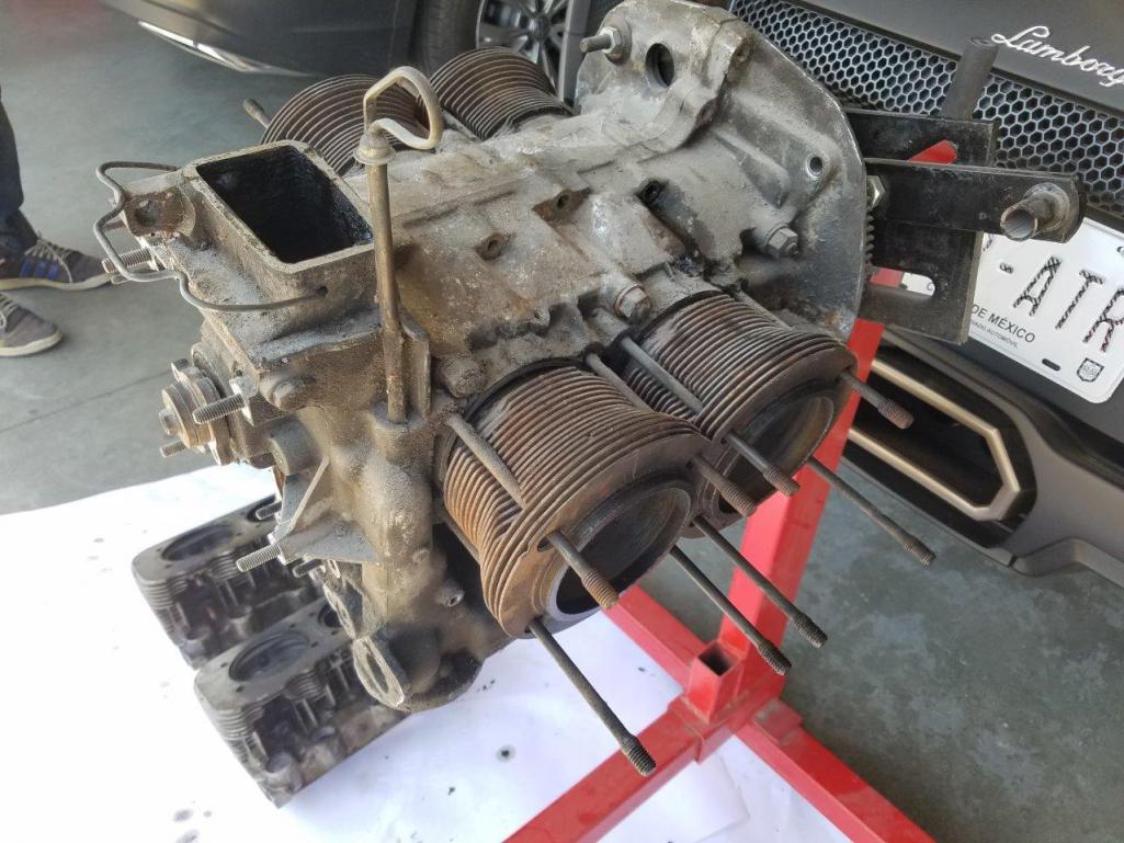

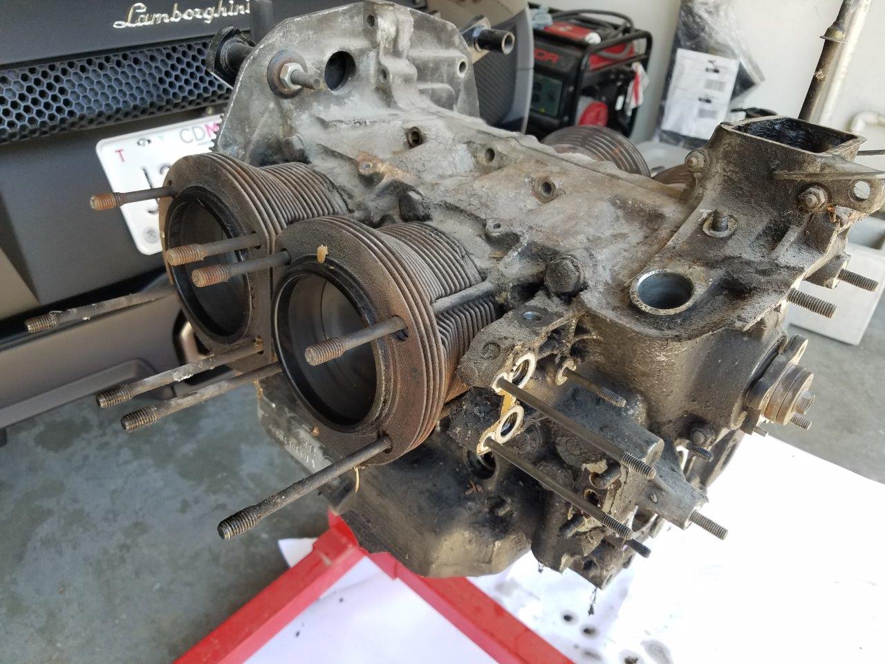

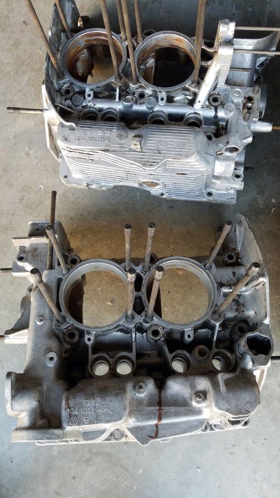

autopro   Got the engine semi torn apart and I also started ...   Apr 30 2018, 08:35 AM
