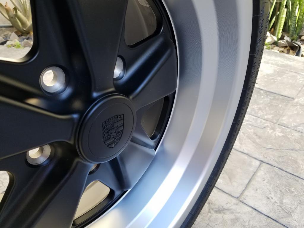

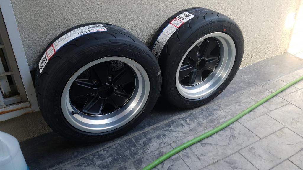

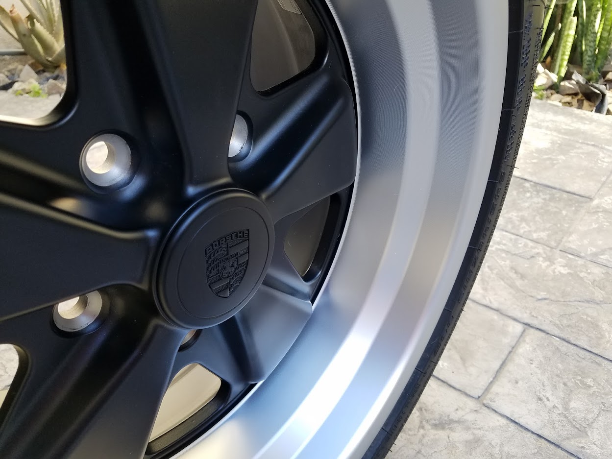

Got my boy some new shoes. Bought these from Maxilite wheels and I think they look great. Sizes are 8x15 and 9x15, tires are FALKEN AZENIS RT660 225/45ZR-15 and 245/40ZR-15
