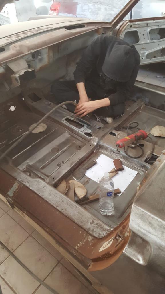

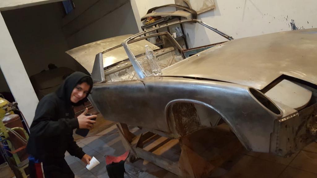

autopro   During my kids summer break I put him to work on a...   Aug 2 2021, 10:12 AM
autopro   Primer inside the cab so it doesn't rust again...   Aug 2 2021, 10:23 AM

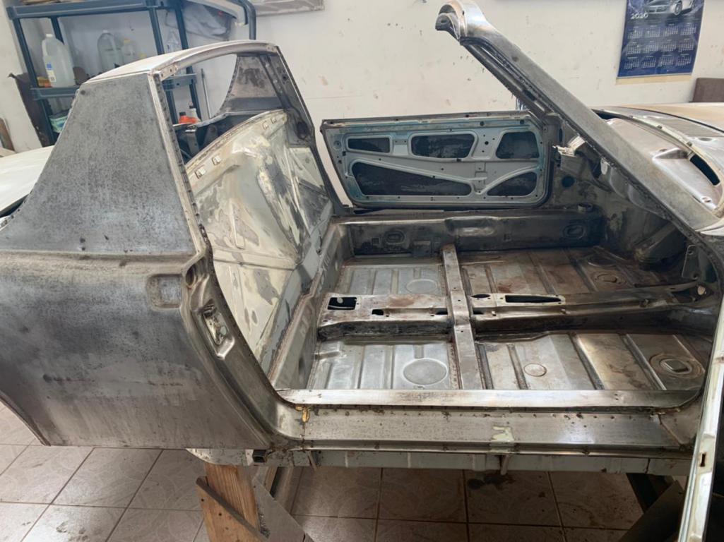

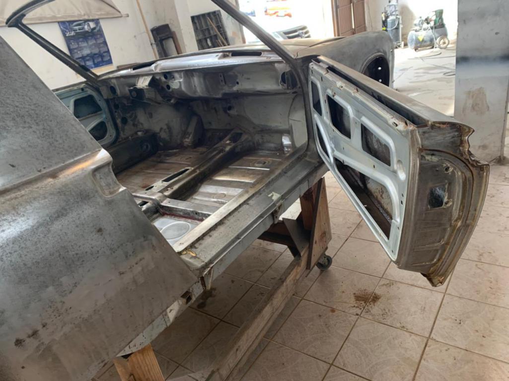

autopro   Well now that the whole body has been taken down t...   Aug 13 2021, 03:01 PM

autopro   Removed all the paint and rust Here are all the...   Aug 25 2021, 08:35 PM
