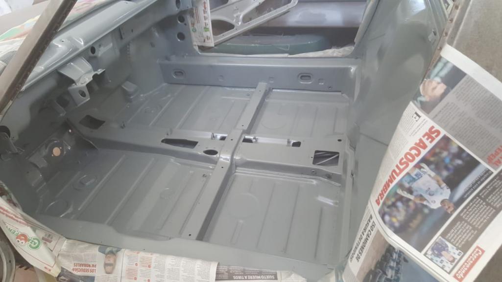

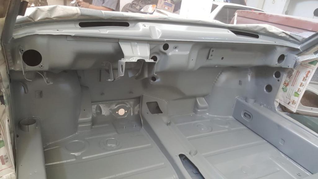

Primer inside the cab so it doesn't rust again.
Here it is, ready for the bodywork to begin (IMG:style_emoticons/default/aktion035.gif)

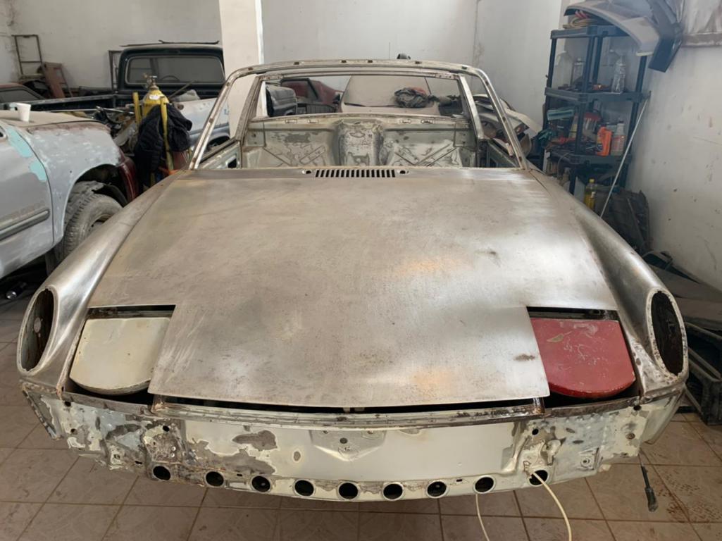

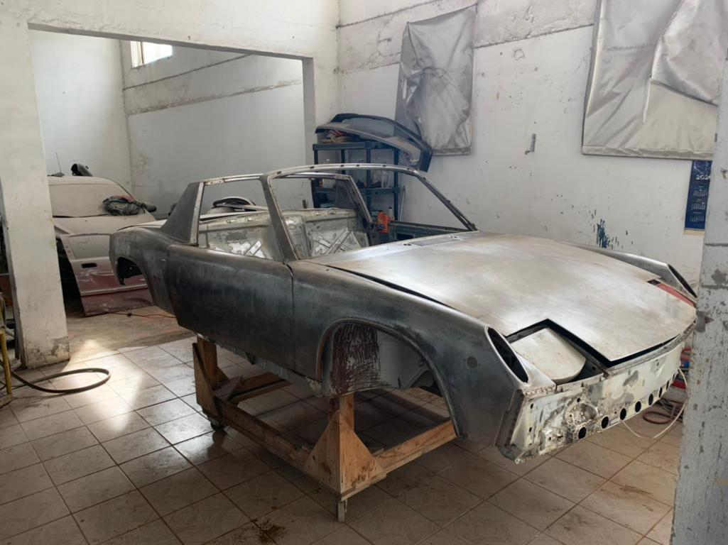

autopro   Well now that the whole body has been taken down t...   Aug 13 2021, 03:01 PM
autopro   Upon arrival at my friends shop, couldn't wait...   Aug 13 2021, 03:47 PM
