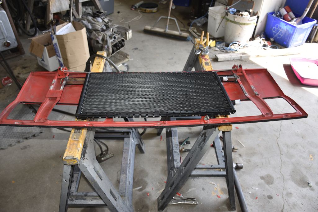

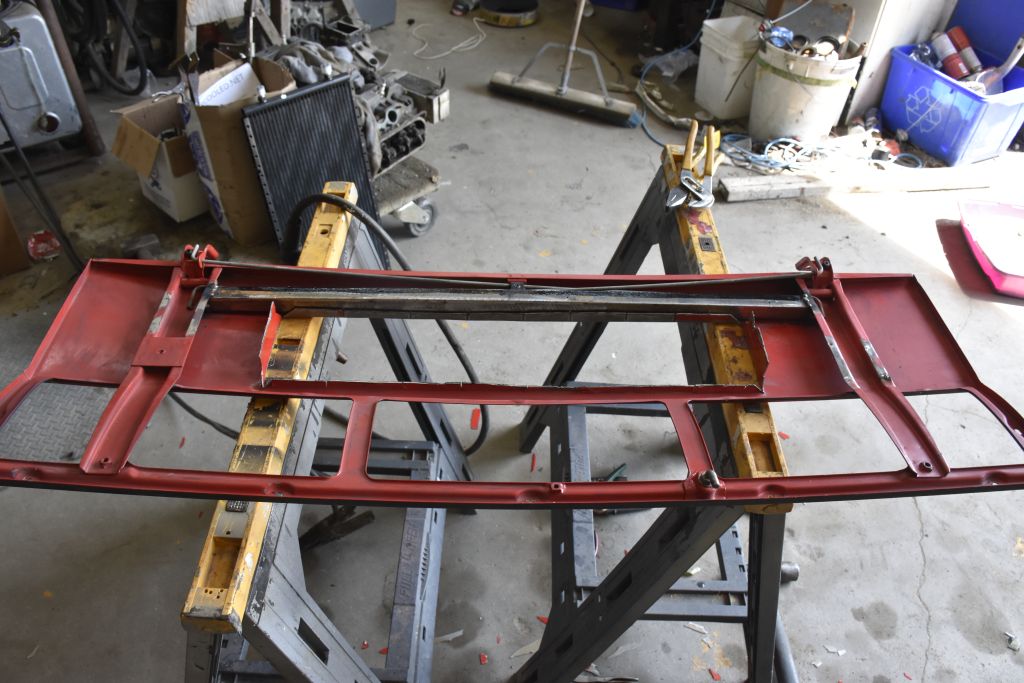

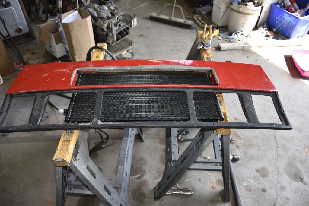

Mark Henry   Doing some work on Warren's GT lid, I think I...   Aug 6 2021, 12:05 PM
Warren914   Interesting approach. How will the new grill trim ...   Aug 7 2021, 11:26 PM
Mark Henry   Interesting approach. How will the new grill trim...   Aug 10 2021, 02:18 PM
AZBanks   How are you going to mount the condenser? Everythi...   Aug 10 2021, 03:24 PM
