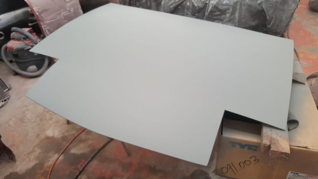

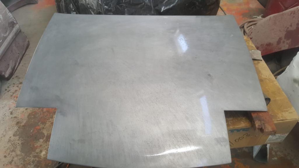

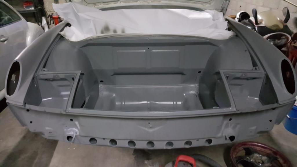

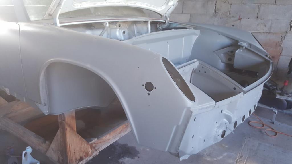

A few more. I was able to finish the whole car and now it will be ready for body work.
