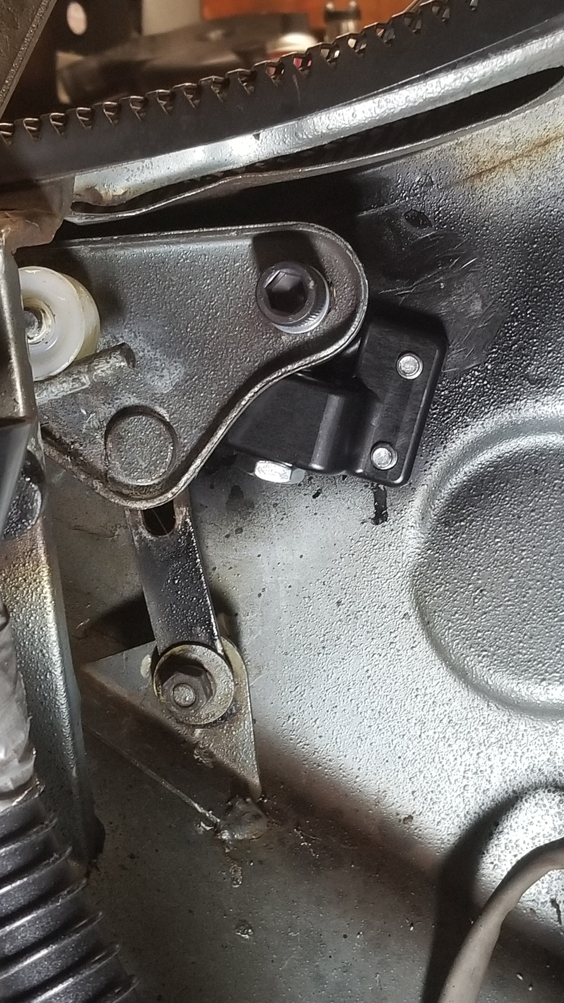

The teener kicked my ass tonight! I simply wore myself out trying to get the rear trunk torsion bar behind the trunk roller.
I searched for as much info as I cold find before beginning this task. I modified my 12" adjustable wrench as mentioned on other threads on this topic. This tool proved to be a very good lever for pushing the torsion bar back. I could get the torsion bar pushed/twisted back well enough but I could not get it around the hinge roller/pin. I tried several times but could not find a way to get the roller behind the pin on the hinge.
I tried to remove the hinge then hold the torsion bar back as far as I could and then reinstall the hinge -This is the task the wore me out! No matter how or what I tried I could not find a way to get the bar behind the roller.
Anyone know the secret/technique to get the torsion bar in place?

Older thread but Doug still deserves kudos for the write up and photos of the sectioned crescent wrench technique. I tried all day Saturday (and busted my a##) with a set up that I thought would work using 1/2" square steel tubing for leverage but couldn't figure out how to hold the spring up in order to get another "bite" on the end. On Sunday, a $9 Harbor Freight wrench and about 7 Dremel disks later and I was able to finish the job in about 5 min. Fantastic!
Thanks again Doug!

Doug Leggins   SUCCESS!!!! http:/...   Oct 5 2005, 08:30 PM
Doug Leggins   transitioning from the 1/4" extension to the notch...   Oct 5 2005, 08:32 PM
Doug Leggins   Using the notched wrench to push the torsion bar f...   Oct 5 2005, 08:36 PM
Doug Leggins   Reaching in from the engine bay with a large screw...   Oct 5 2005, 08:37 PM
Doug Leggins   Screwdriver used to pry the bar around the end of ...   Oct 5 2005, 08:40 PM
Doug Leggins   Torsion bar on the back side of the roller pin...   Oct 5 2005, 08:41 PM
Doug Leggins   Slipped the roller on the pin, cautiously eased up...   Oct 5 2005, 08:45 PM

jrmdir   Success! I've owned this car for over 2 m...   Aug 10 2021, 02:32 PM
