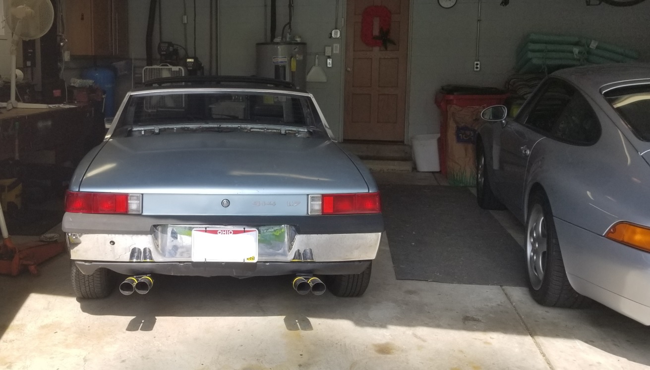

post Aug 10 2021, 02:32 PM
Posts: 224
Joined: 13-May 21
From: Central Ohio
Member No.: 25,544
Success!
I've owned this car for over 2 months and until today have never seen it without the left side of the trunk sticking up an inch and a half! Nice Butt!
Ron
