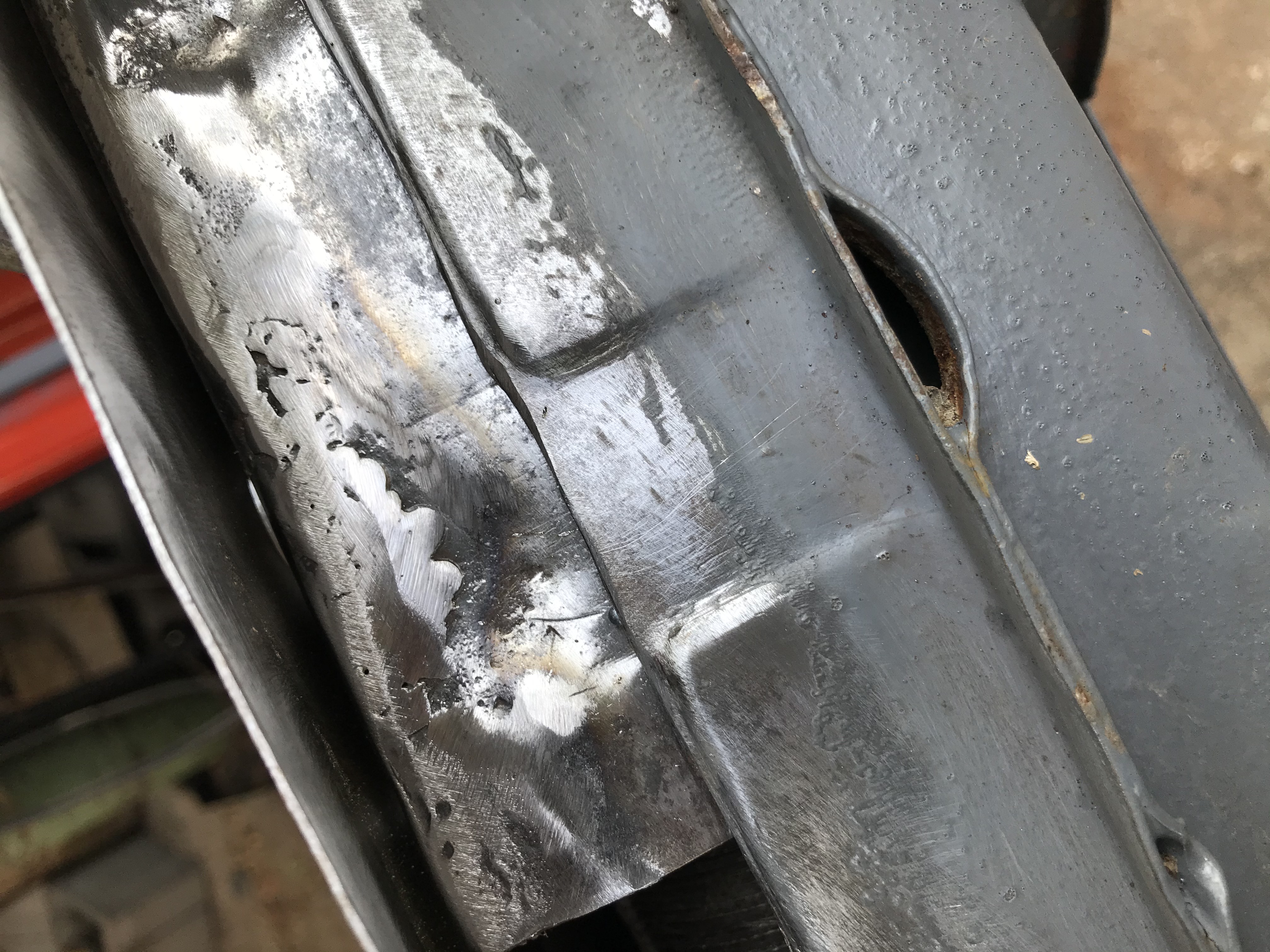

post Aug 10 2021, 09:43 PM
Posts: 2,420
Joined: 16-November 06
From: Dallas, TX
Member No.: 7,222
Welded up holes from spot welds and the crack under the belt mount:
