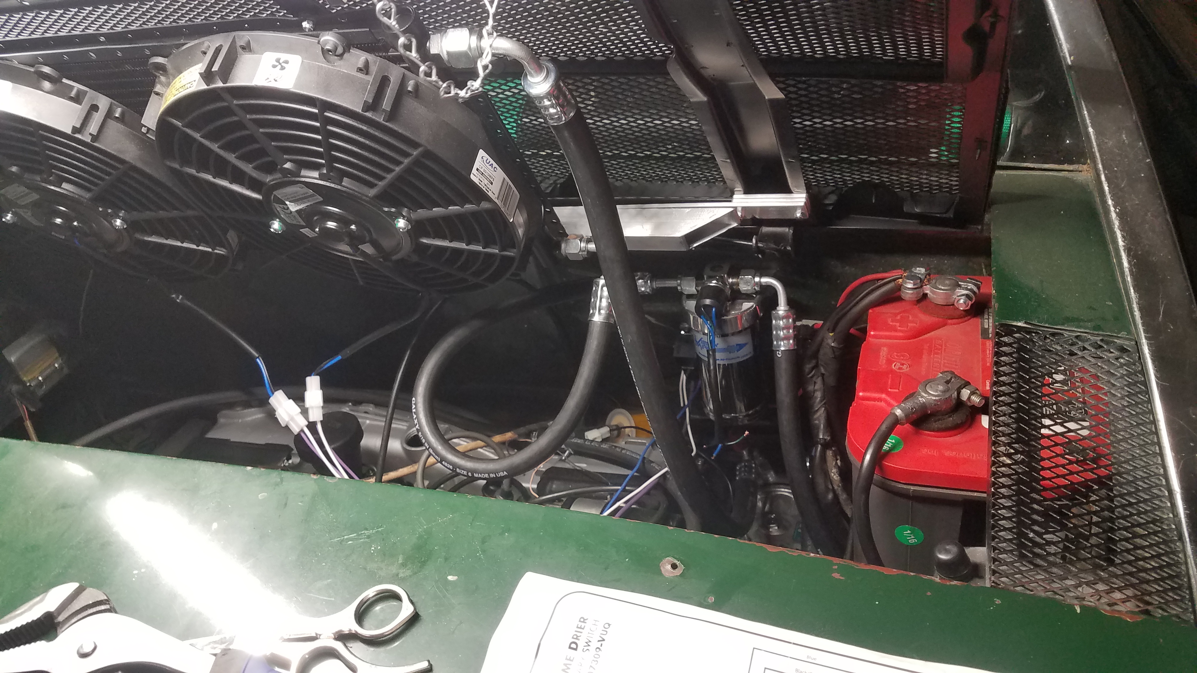

The big/inflow connector from the compressor is at the top of this picture. It is higher than the smaller/outflow port when the lib is raised and when it is closed.

AZBanks   How are you going to mount the condenser? Everythi...   Aug 10 2021, 03:24 PM
Warren914   Large hose is high pressure vapor from the compres...   Aug 10 2021, 08:38 PM

Warren914   Flip it 180 degrees. Really??? :huh: Thanks f...   Aug 11 2021, 09:18 AM
AZBanks   The big/inflow connector from the compressor is at...   Aug 11 2021, 10:52 PM
AZBanks   The picture isn't great but you can see a litt...   Aug 11 2021, 10:54 PM
AZBanks   I can take more close up pictures if you want to s...   Aug 11 2021, 10:59 PM
