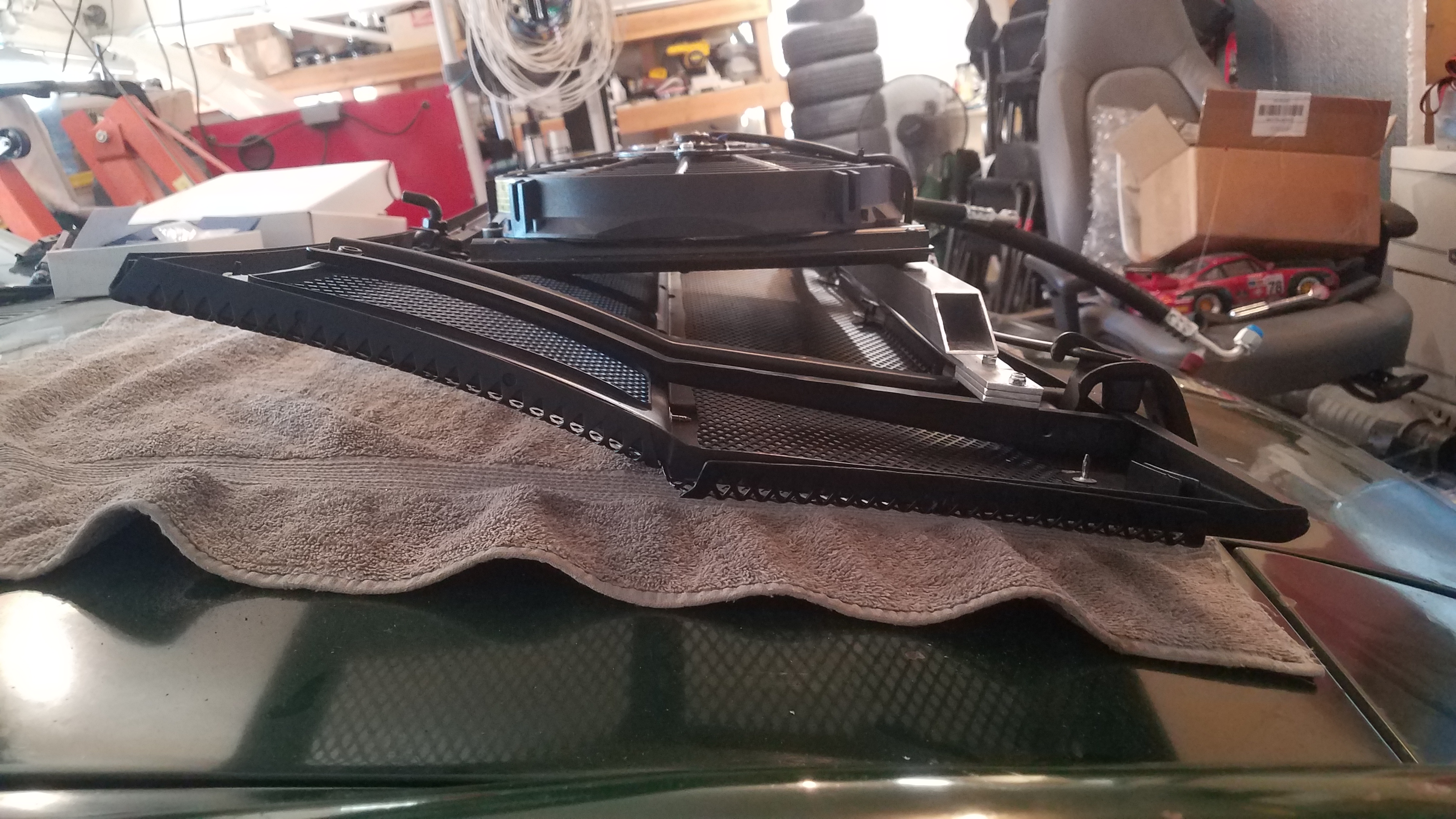

I have an air conditioning unit for the 914, another part of my 20 year old clutter pile. I'm reluctant to chop the bottom out of the trunk for the huge condensor coil. It would need a new compressor and hopefully a smaller condensor coil could be made to work. How much work to install? Is it worth the effort?

I can take more close up pictures if you want to see how the condenser is mounted to the aluminum and the lid.

AZBanks   How are you going to mount the condenser? Everythi...   Aug 10 2021, 03:24 PM
Warren914   Large hose is high pressure vapor from the compres...   Aug 10 2021, 08:38 PM
Mark Henry   Really??? :huh: Thanks for letting me know about...   Aug 11 2021, 08:04 AM
Warren914   Flip it 180 degrees. Really??? :huh: Thanks f...   Aug 11 2021, 09:18 AM
AZBanks   The big/inflow connector from the compressor is at...   Aug 11 2021, 10:52 PM
AZBanks   The picture isn't great but you can see a litt...   Aug 11 2021, 10:54 PM
AZBanks   I can take more close up pictures if you want to s...   Aug 11 2021, 10:59 PM
