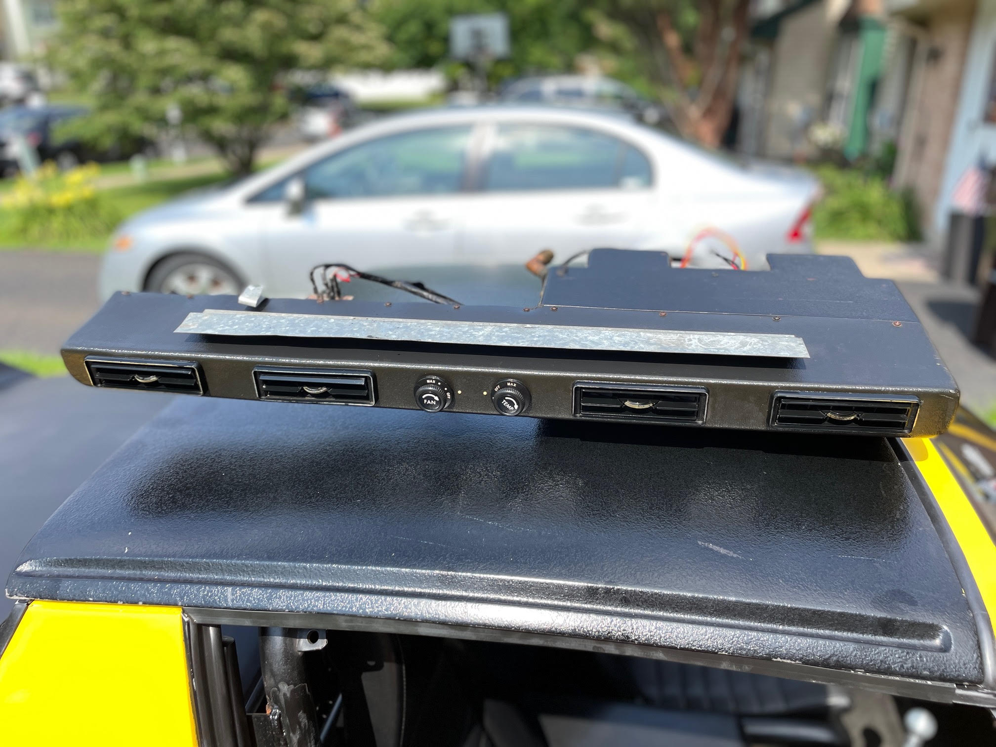

Spocknasty
post Aug 12 2021, 10:52 AM
Posts: 20
Joined: 1-May 21
From: Philadelphia, PA
Member No.: 25,498
If anyone is interested in an under dash mounted control unit to incorporate into a complete system, I have one collecting dust. (Classic Auto Air quoted $1,324 for the rest of the components in their kit).
