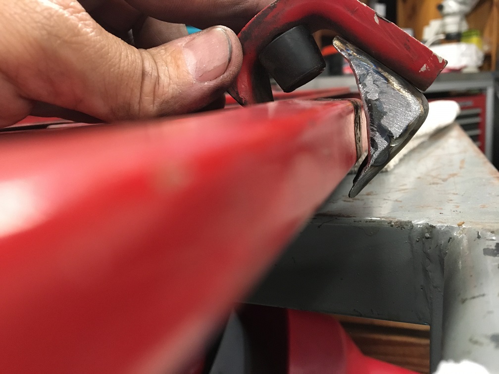

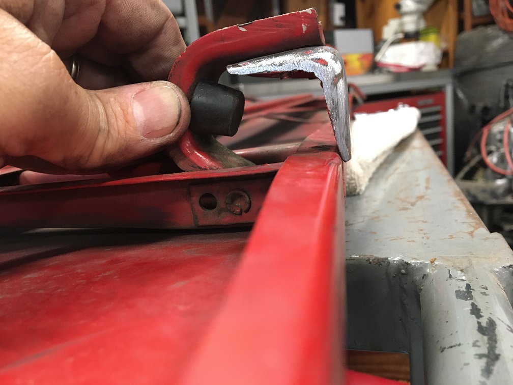

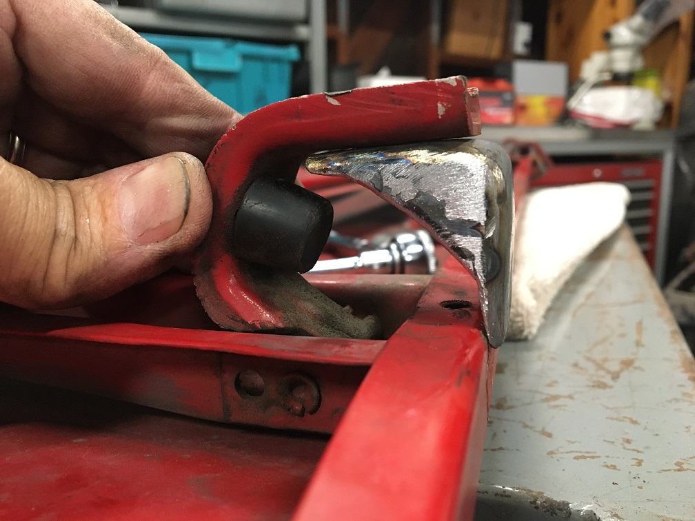

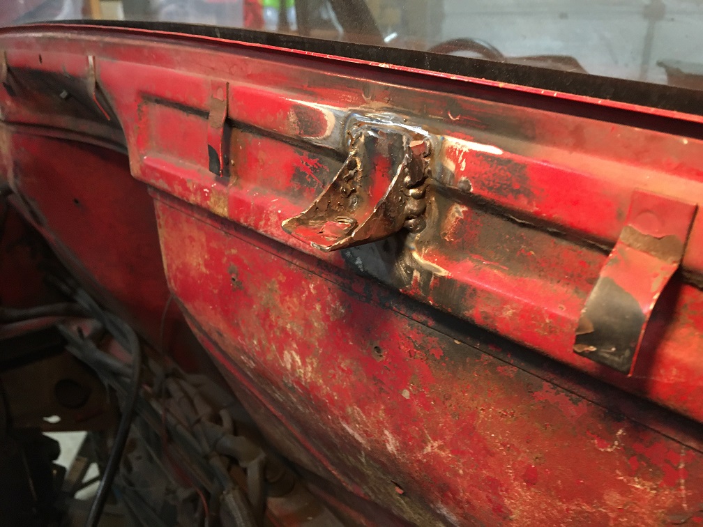

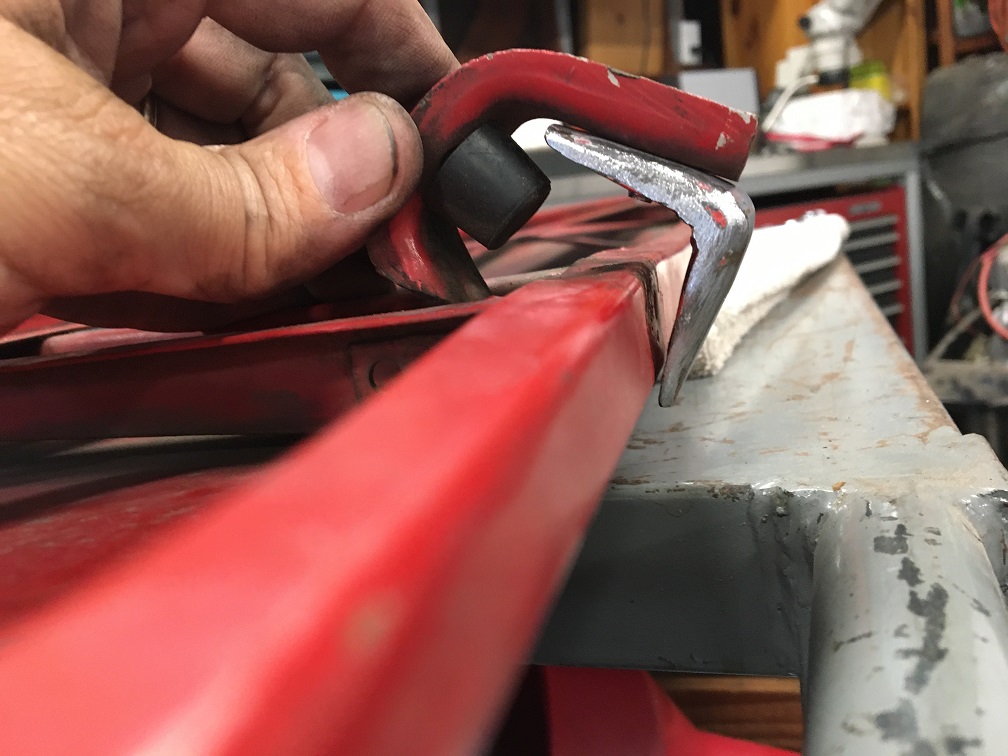

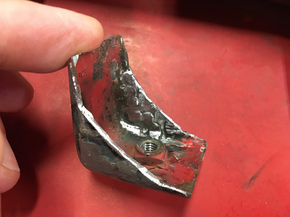

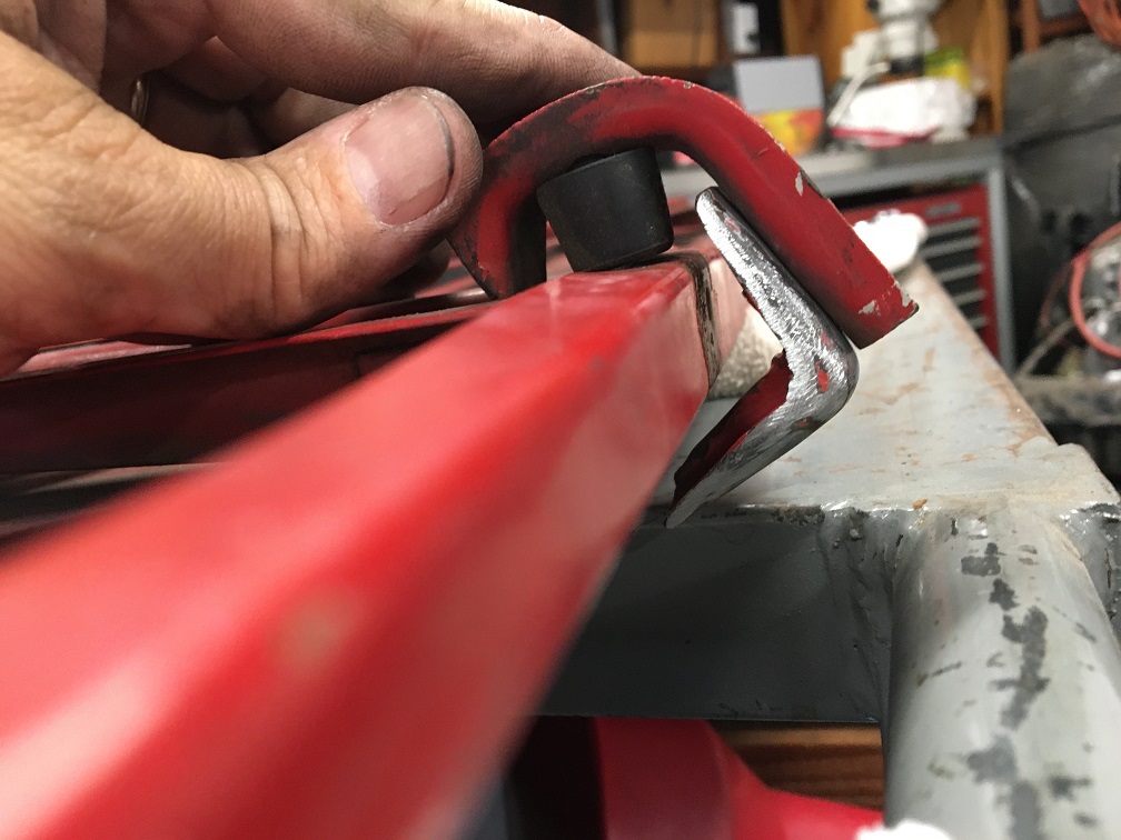

Time to move on to the engine lid, which also needs help... (IMG:style_emoticons/default/smash.gif)
Typical 914 engine lid bracket issues, both have been repaired, but the passenger side one is broken again. (IMG:style_emoticons/default/dry.gif)
I got a pair of original brackets at one of Bruce Stone's swap meet a while back knowing I was going to need them.
These typically fail in two ways:
1- at the bend (like mine)
2- detach from or rip the firewall.

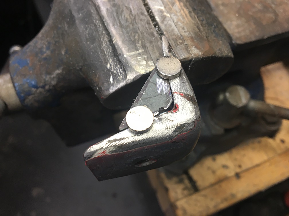

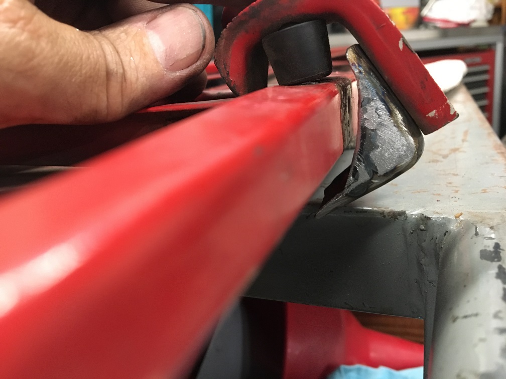

Thinking of ways how to prevent this to happen again, at least problem #1, I did this little clearance study:
Clearly, there is room on that "L" bracket to add a gusset on each side making it a lot stronger.
So here we go! (IMG:style_emoticons/default/smile.gif)
Once done:
After a little trimming and adjustment, here is the updated clearance study: (IMG:style_emoticons/default/smile.gif)
I am pretty sure this is the end of the bracket cracking problem! (IMG:style_emoticons/default/sunglasses.gif)
Here the rebuilt bracket is welded to the firewall on the sides catching more of that embossing. Hopefully, this will also prevent problem #2 explained earlier. That being said, all of these issues can probably be avoided by holding the engine lid as it is being released. An easy good habit that many of us have very early on adhered to for obvious reasons. (IMG:style_emoticons/default/smile.gif)
Not shown, but the engine lid was properly aligned to the body in order to set the "L" bracket in the right location on the firewall.
