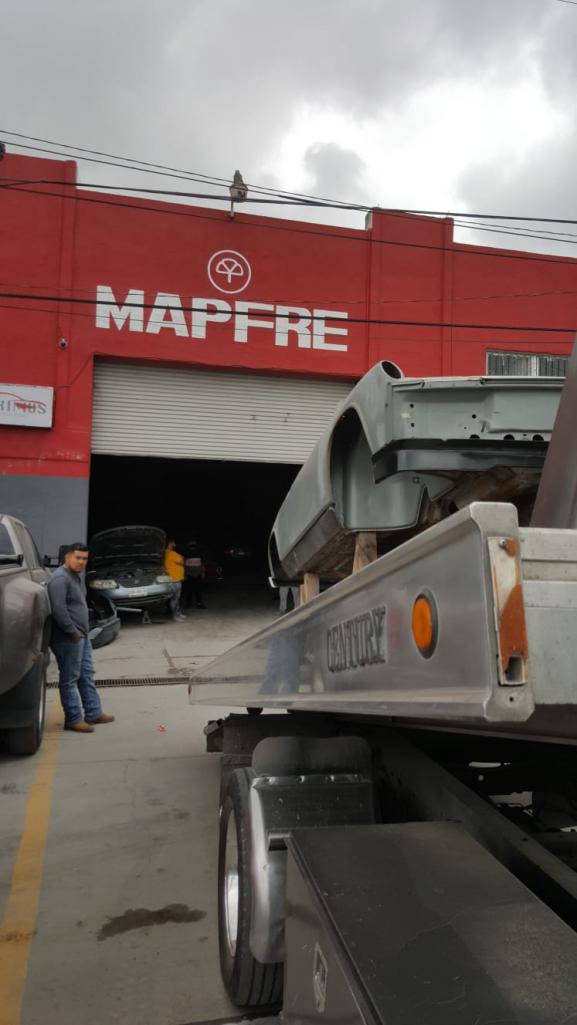

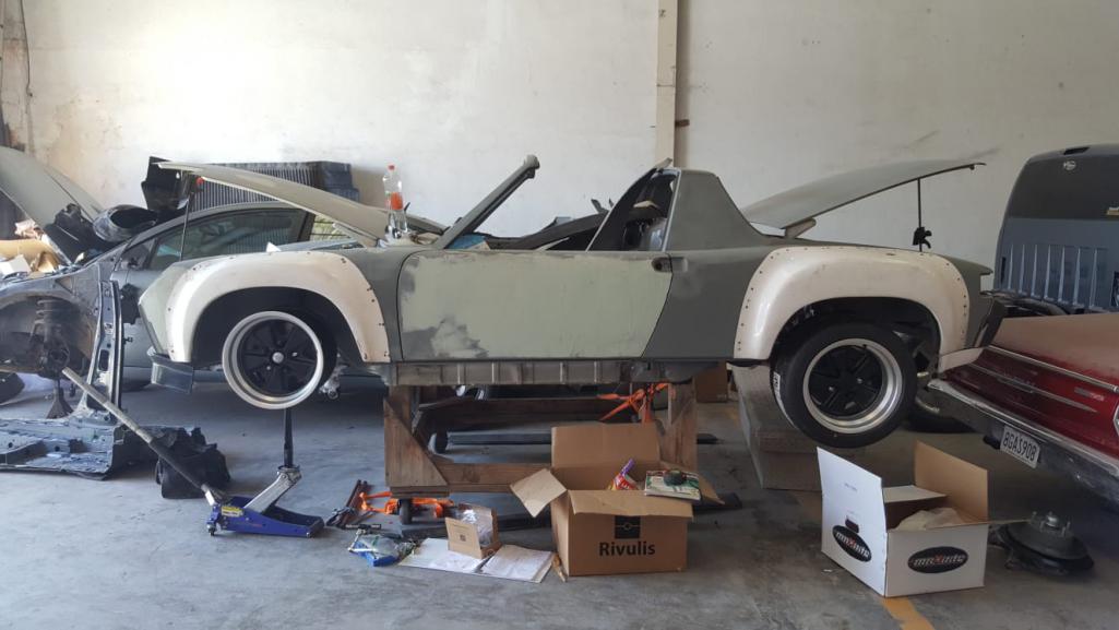

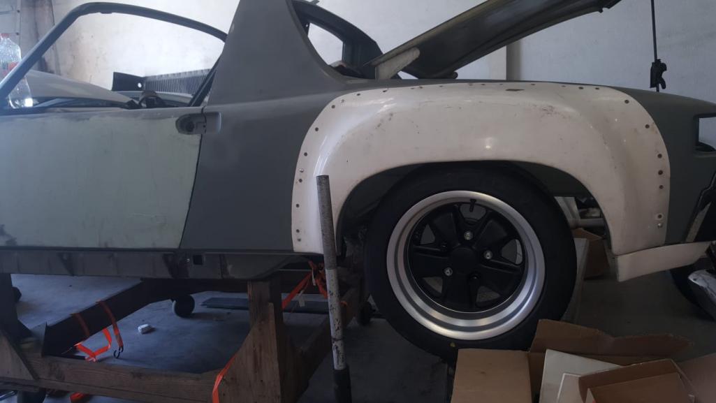

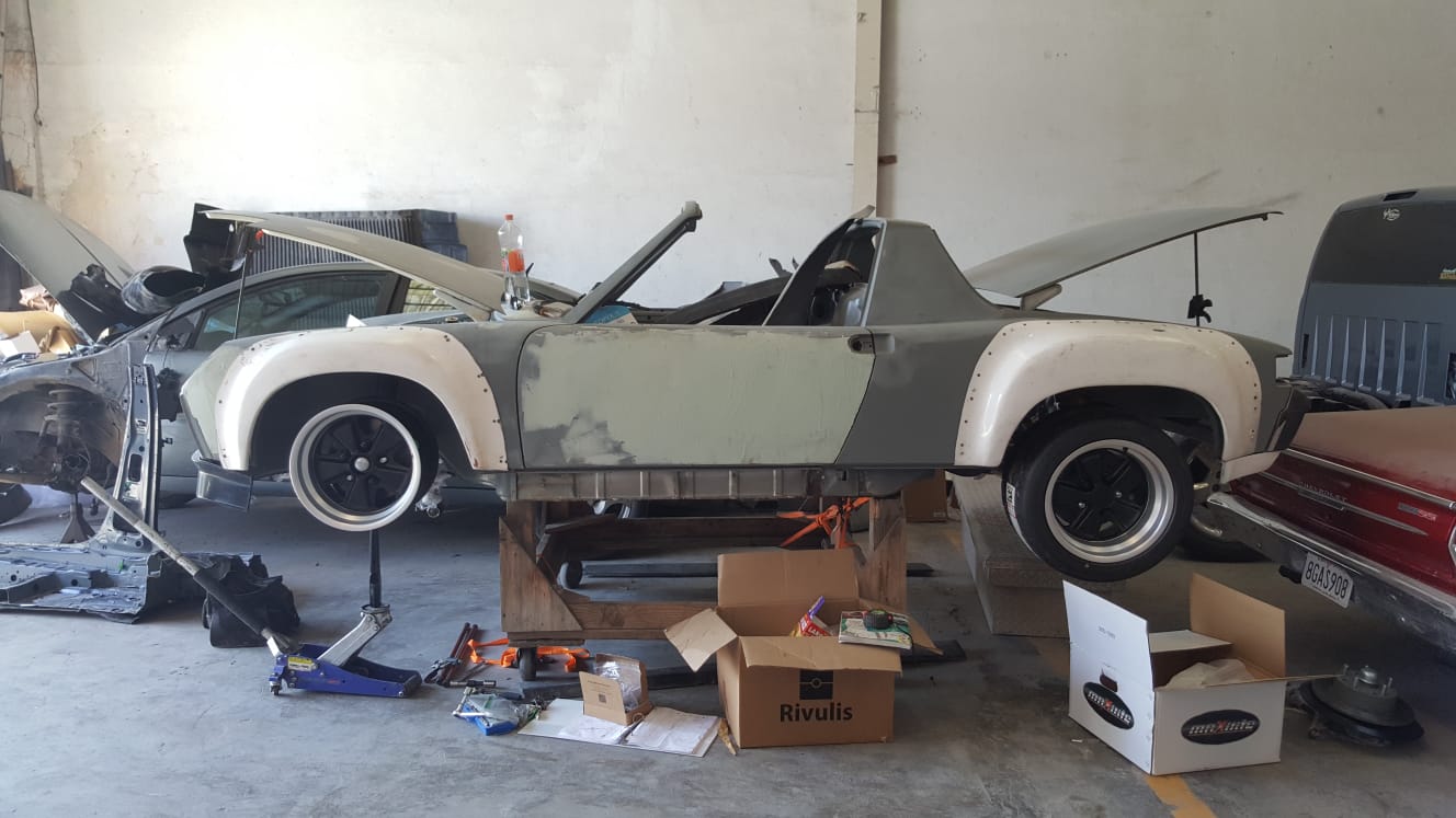

Upon arrival at my friends shop, couldn't wait for the work to begin (IMG:style_emoticons/default/biggrin.gif)
First thing I did was install suspension and wheels to check the fitment of the fenders. At this point I didn't have the front tires, but I got them before the final fitment of the fenders. |
