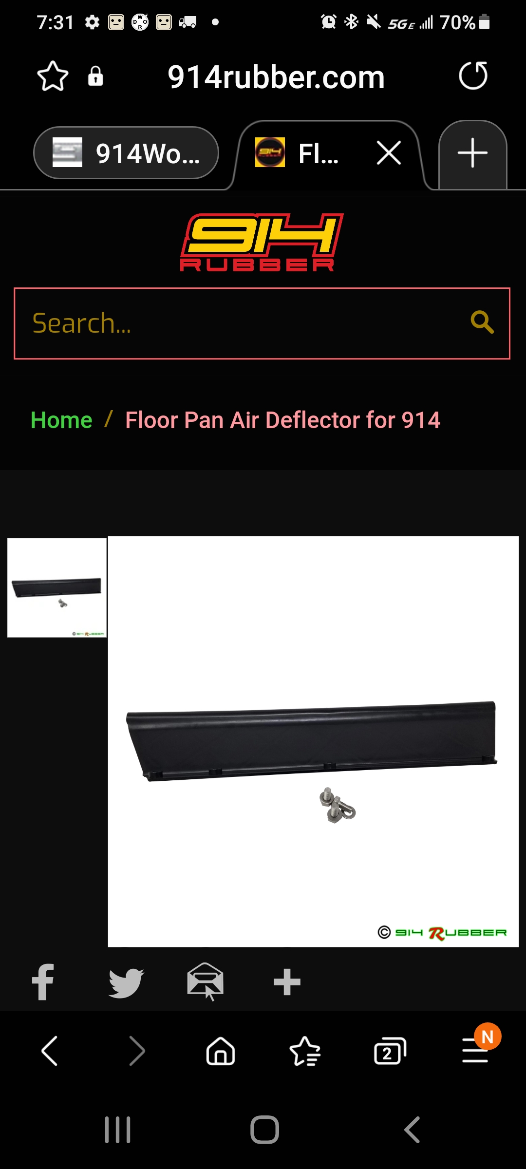

I'm interested. We could thermoform some ducts that could be easily installed and removed without damage to the body. As noted in the aerodynamic studies there is a backward flow of air on the deck. Ducting to the sides would allow for cool air to displace stagnated air at a much faster rate. This should help with cooler Temp air supplied to the intake and fan housing. Resulting in a higher air density and cooler air over the head and cylinder fins.
As another member noted the aerodynamic quiet spot just past the firewall needs to be broken up. The air deflectors do this quite well. We added tip vortex generators to maximize the efficiency.
These are a pretty simple add to any car.
https://914rubber.com/floor-pan-air-deflector-for-914
We include the hardware too.
The LE spoilers also help.
