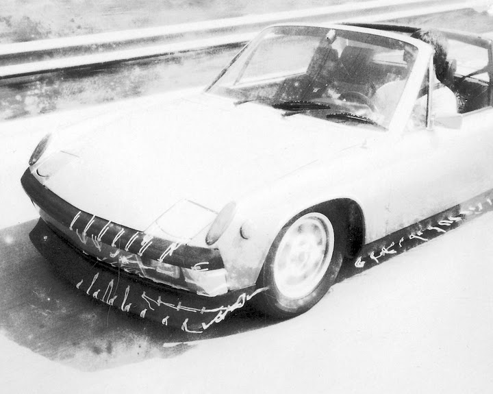

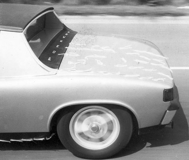

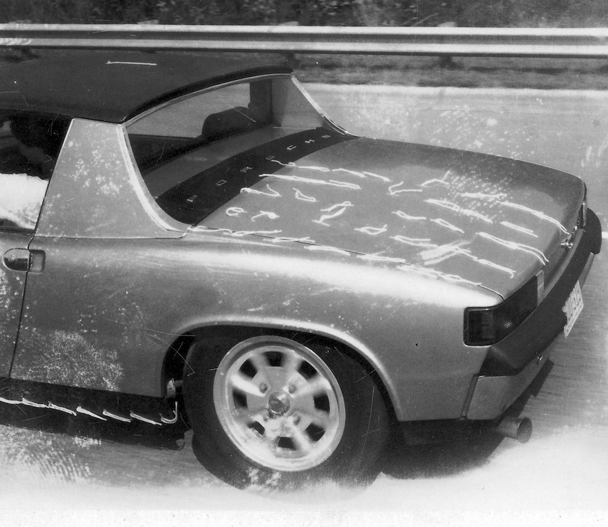

Next question? Thse are al found on my 914 Classic site under Vintage Photos.

QUOTE(JeffBowlsby @ Aug 15 2021, 11:21 AM) *
Wow..never seen these before. Just goes to show you that they knew what they were doing when they originally designed the body in white car.
When I first read the title of this thread...I don't think you want "higher pressures" in front of the fan. Like Mark said...you want lower pressure as this is a forward curved scroll fan. If turbulence is created around those tips, the fan becomes less efficient at doing this. Thiink of an airplane wing here. You might get cooler air but I seriously doubt you will get cooler engine temperatures by doing that as fan efficiency will be sacraficed. This is why the deflectors are there at the end of the body pan.
