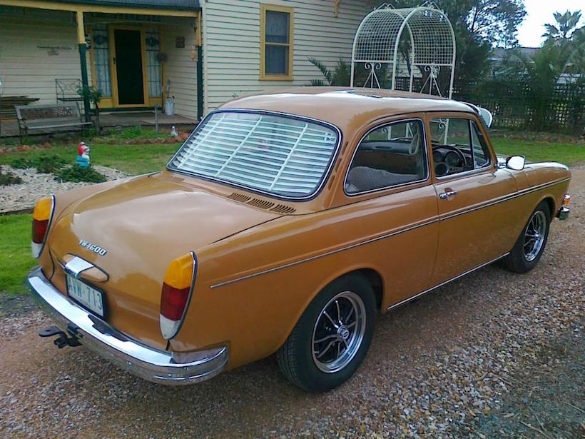

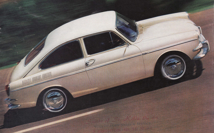

a detail i used to notice about vw type 3s was the difference between air grille intakes on a notch versus a fastback. the fastback had them on the flanks and shared its rear guards with the squareback. it would have made mass production economic sense to also share the rear guard set up for the notch but they didn't.
it must not have been aerodynamically good for the inflow into air intakes on the flanks.
the 914 is similar to the notch in a way. its a blunter rear to the cabin turret.
there was no difference in the rear profile rake of a 4 door 411/412 or a 2 door fastback.
somehow that rake must have better suited intake vents on the rear deck lid.
it is interesting where they position those vents on the various cars dependent on rear profile.
having said that, a 911 is a fastback shape and has the intakes on the lid, so the type 3 fastback is a bit of a mystery to me.
they didn't have any choice with the squarebacks, no other place but the flanks.
