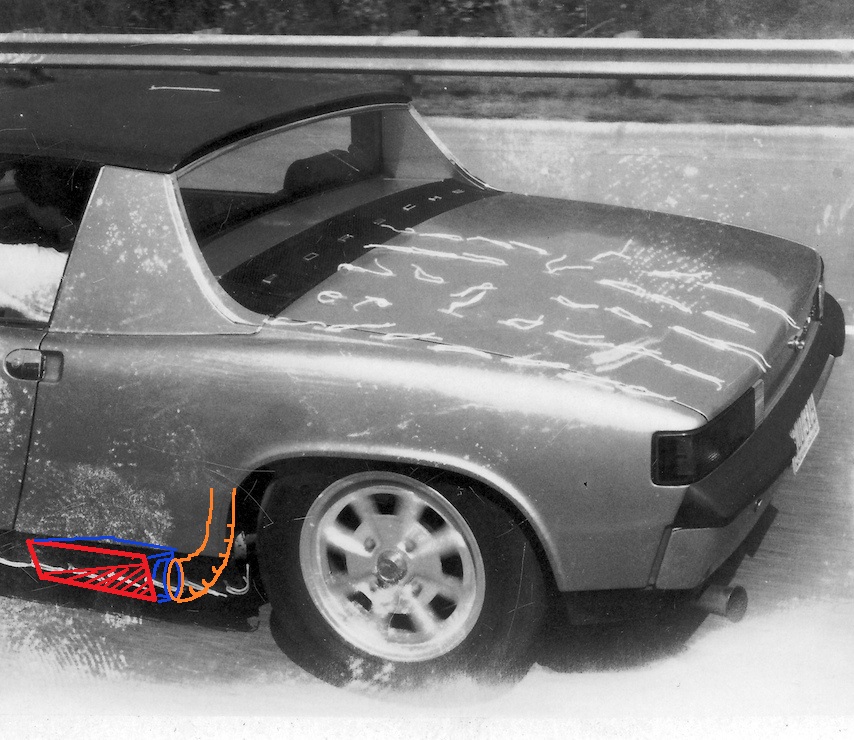

Seems to have good air flow on the rocker and they come in fiberglass. Could pick up some cool air with a scoop and think brake cooling ducts. That size from each side would bring in some air with out over pressurizing the engine bay. (someone mentioned fan issues) Maybe like this: Red is exposed, blue is inside with start collar and orange is the flex tube to a small collar added to let air into the engine bay. (IMG:style_emoticons/default/confused24.gif)
