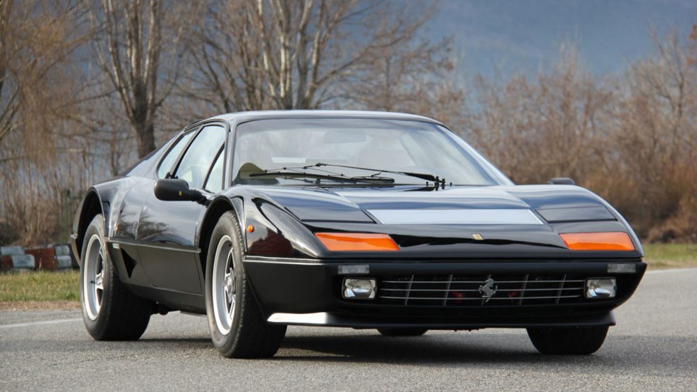

QUOTE(Shivers @ Aug 16 2021, 03:58 AM) *
And worked well on the Ferrari BB (IMG:http://www.914world.com/bbs2/uploads_offsite/d39a3h63xew422.cloudfront.net-50-1629131747.1.jpg)
