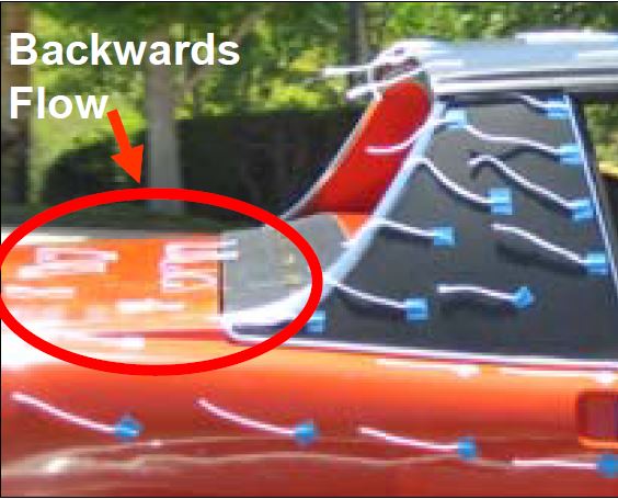

Another pic of the engine lid airflow...
the quick and easy is to:
add 914 Rubber's air deflectors (what factory did for 914-4)
add one of Sergio's GT engine lids (what factory did for 914-6 GT)
and if it's still a problem.. the as mentioned oil cooler which also adds capacity (what the factory did for 914-6 GT)

Superhawk996   There really is no need for guessing what is possi...   Aug 16 2021, 05:56 PM
