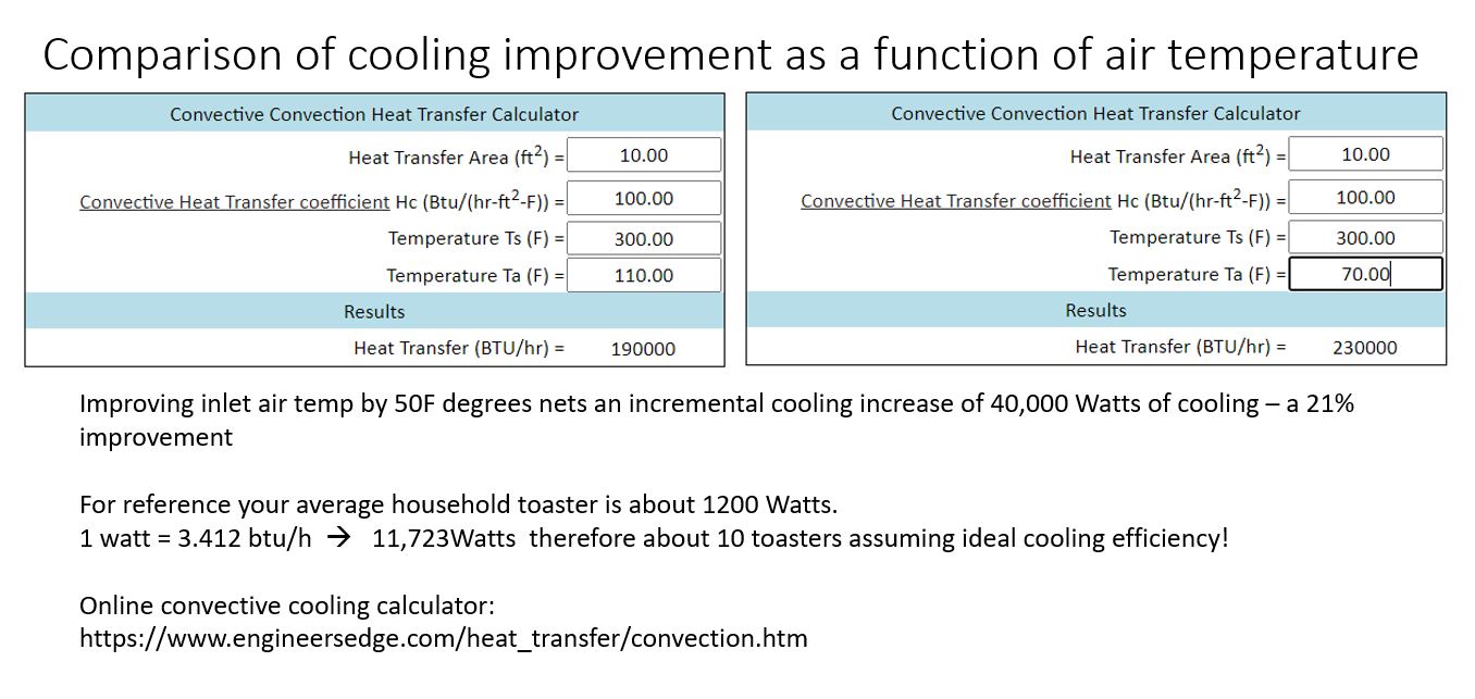

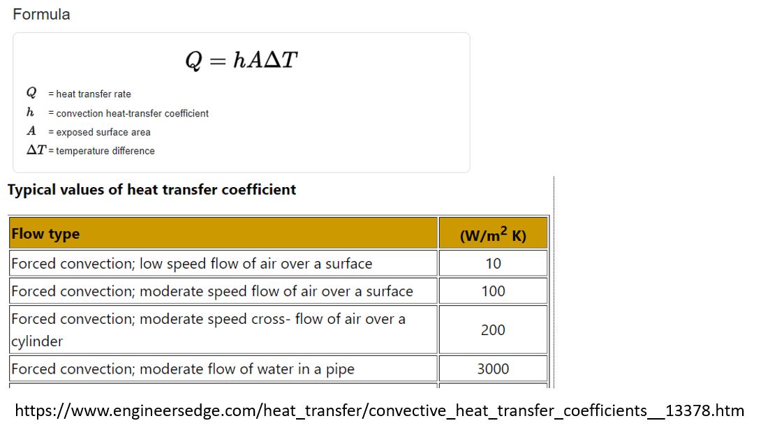

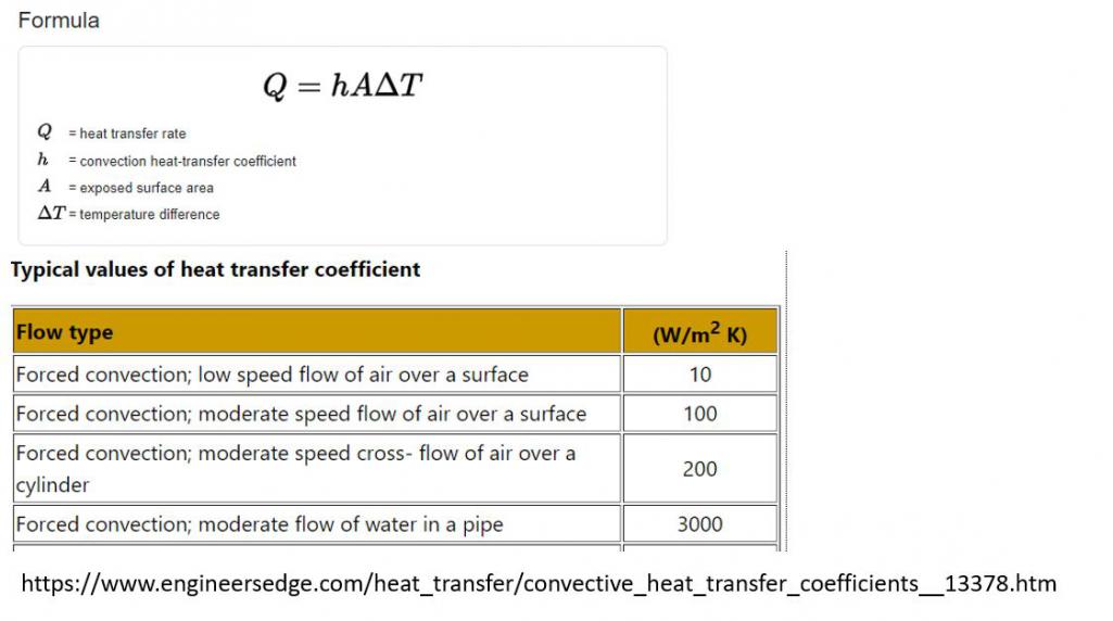

Here is the defining equation for convective heat transfer (air cooling) and the associated cooling coefficients for air vs. water.

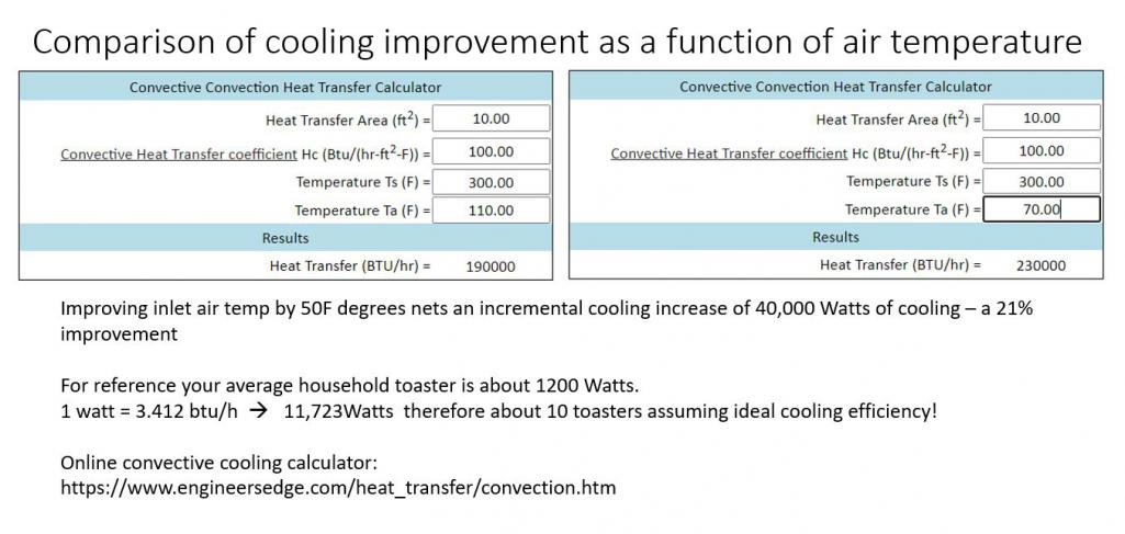

Now let's look at how much the heat transfer would increase if you could get a 50 40 degree decrease in inlet temperature vs. what you currently have. Assumed a head temperature of 300F and ambient air of 110F as baseline.

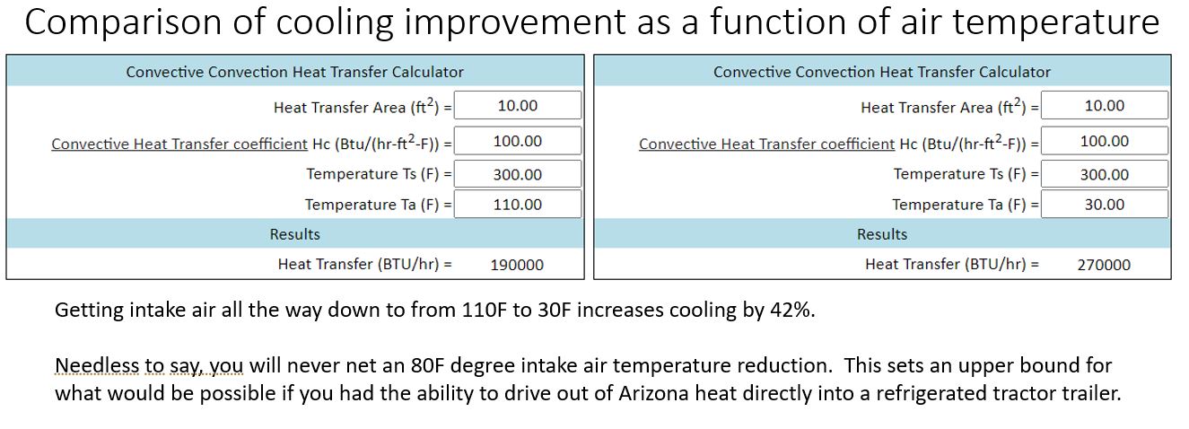

Now let's look at what the increase would be if you could go from 110F right into a refrigerated box at 30F.

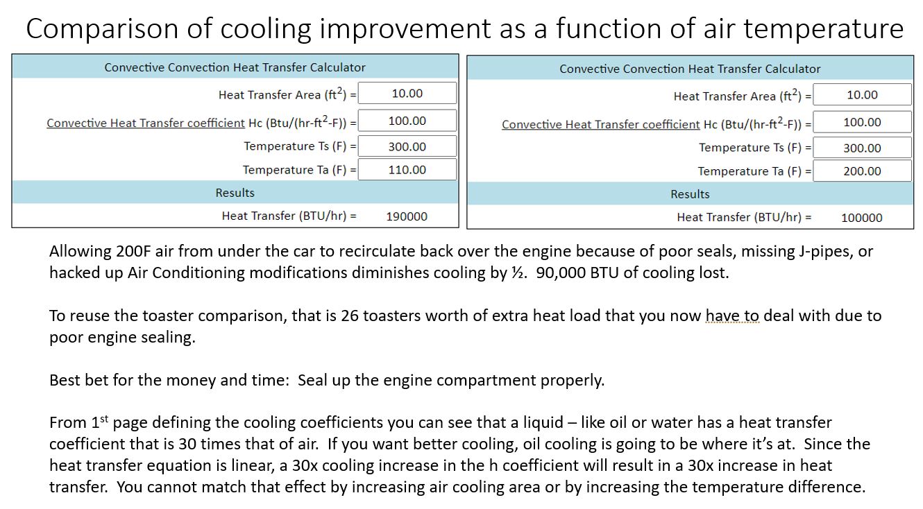

And most importantly - lets look at what happens if you have poor engine sealing and start recirculating hot air from under the engine back to the fan intake.
The end game should be obvious. More to be gained by ensuring the engine is properly sealed vs. trying to bring in cooler air.
Likewise, the switch from air cooling to oil cooling (or water) is a 30 times more efficient solution as far as heat transfer goes.
Still applaud the experiments and agree some improvement is bettering than none. Just wanted to put some numbers and percentages to what is feasible rather than speculating.
