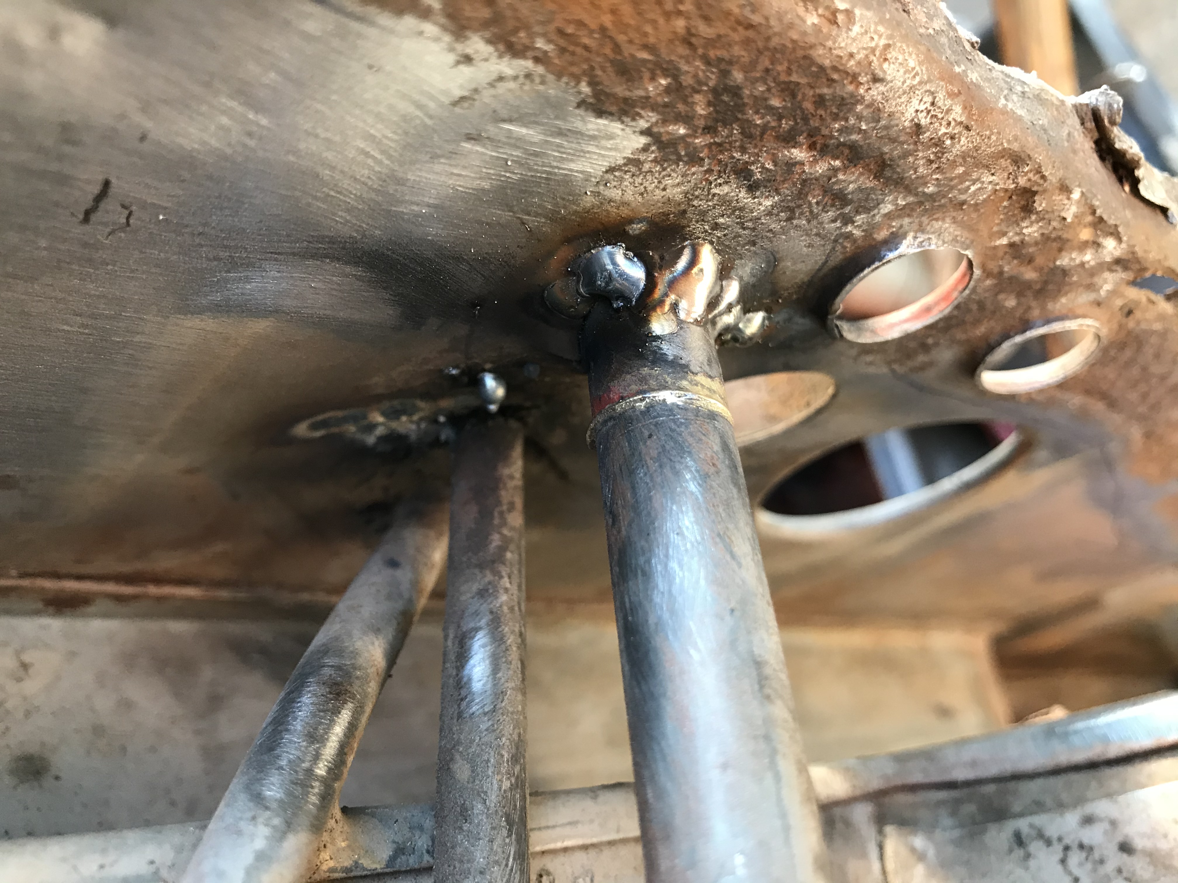

Literati914   Ok so today I removed the rear under side of the t...   Aug 16 2021, 09:06 PM
Literati914   Very Loose clutch tube   Aug 16 2021, 09:13 PM
Literati914   ..both repaired   Aug 16 2021, 09:15 PM
