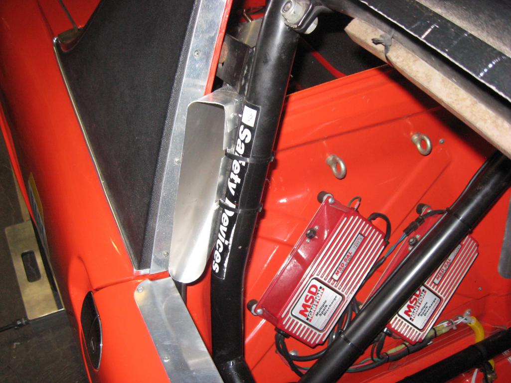

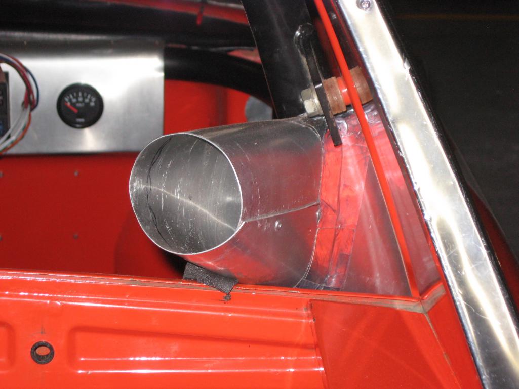

2 cents from my experiments with added air.
We used the air feed to run to a cooler
version 1 was a scoop below the firewall
version 2 was this scoop out the passenger side window
Version 3 was an electric fan
all 3 were measured with a temp gauge on the cooler, run on the track, multiple weekends...
the electric fan out performed both ram air scoops
I'm just saying... add an electric fan if you want to on the engine lid
but these are not likely to make a big difference on your head temps
I think the ram air from the front (big 6inch pipe through the length of the car) would be the only one that would show a significant improvement.
