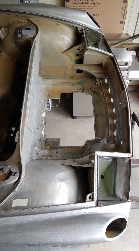

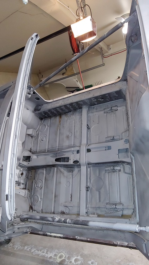

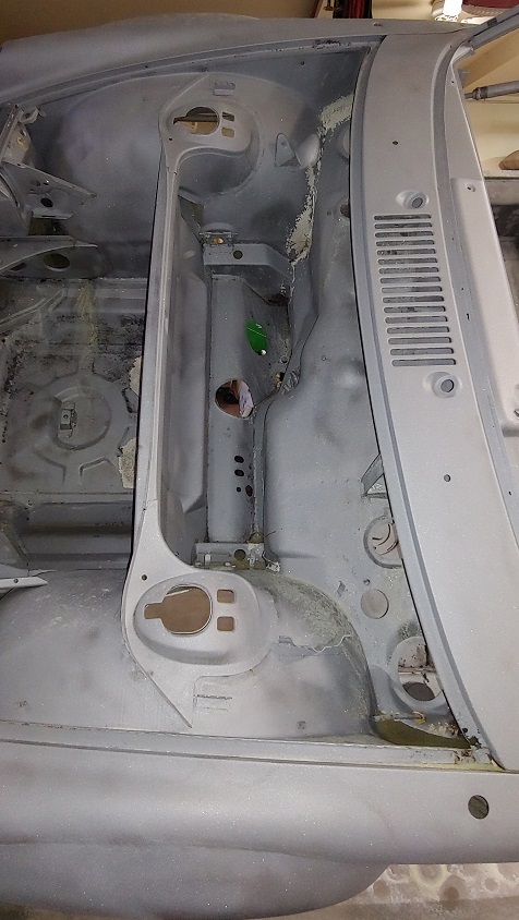

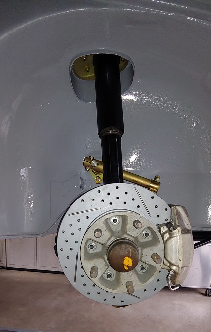

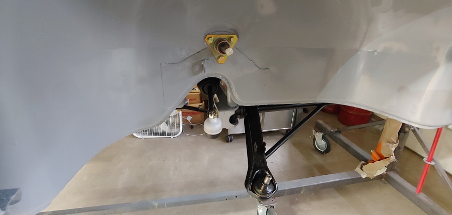

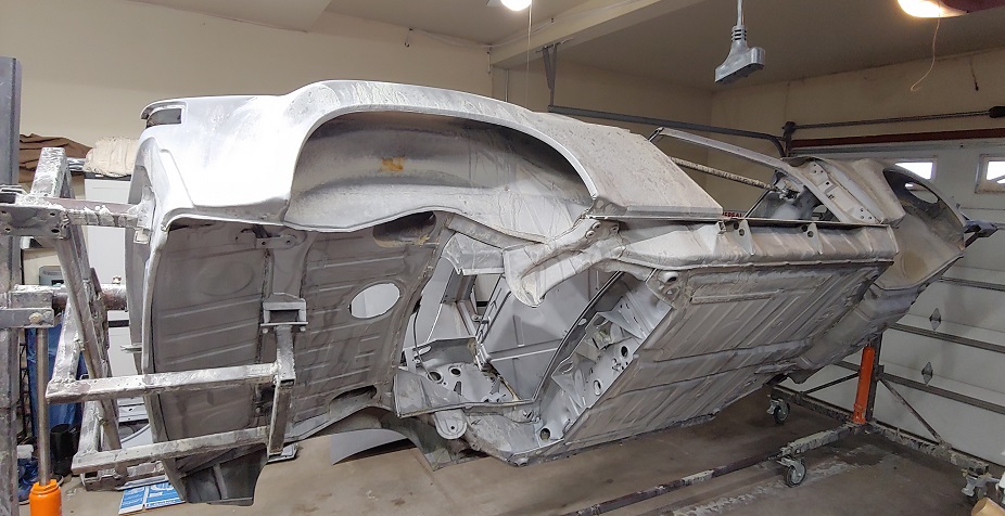

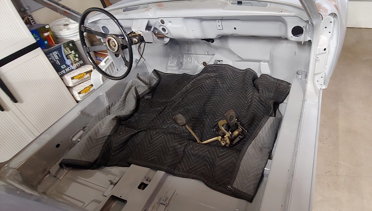

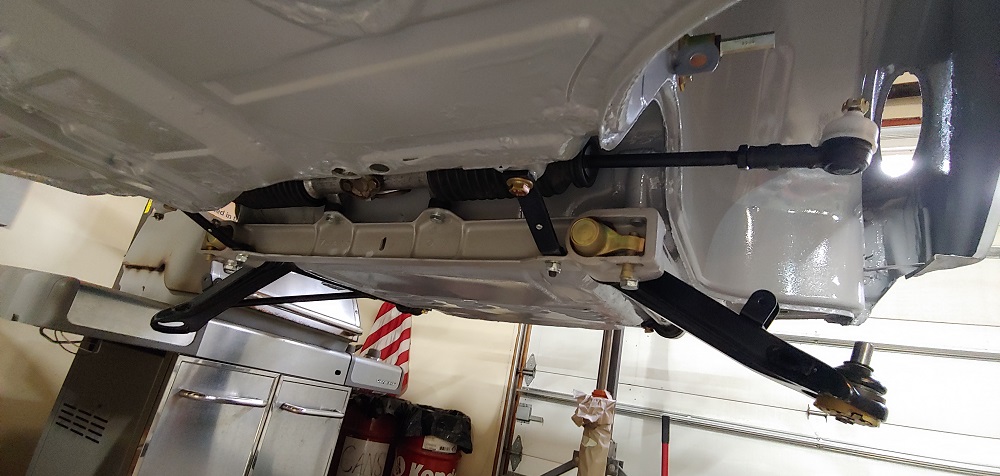

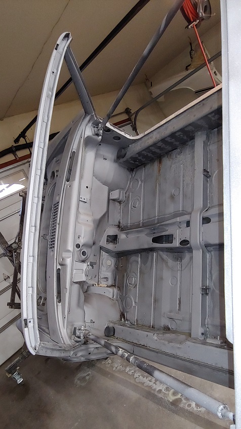

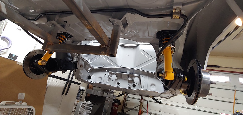

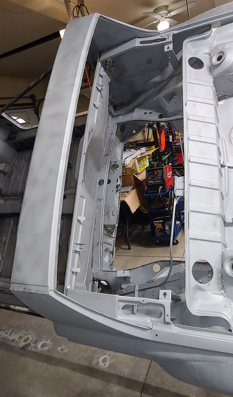

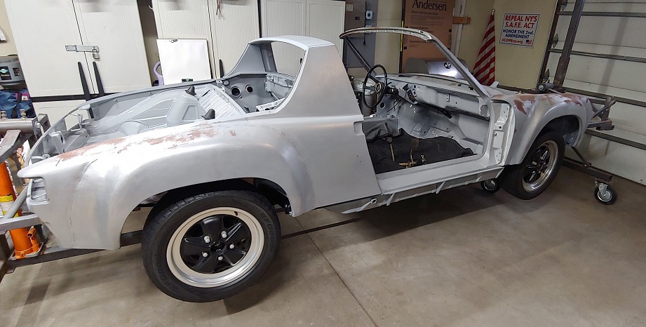

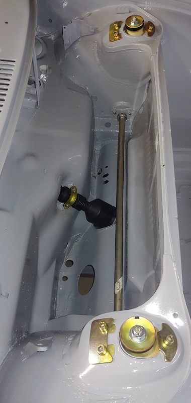

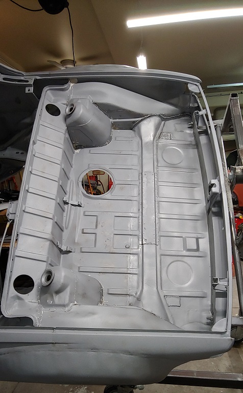

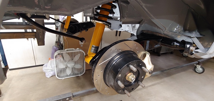

Well after weeks of cleaning and prepping we finally got my brothers 914 in epoxy, seam sealed and into paint. The whole underside, inner fenders, engine bay, interior, and both trunks are body color. The exterior needs to be finished yet. We still need to do a final sand and clean to the body. Once that's done my brother will have a buddy of his that does paint work finish the exterior. We got the suspension installed along with the steering column. Still waiting on several brake parts to arrive then will get the brakes all plumbed and bled before she heads out of my garage. Meantime we will install a few other items. Stay tuned. (IMG:style_emoticons/default/beerchug.gif)
