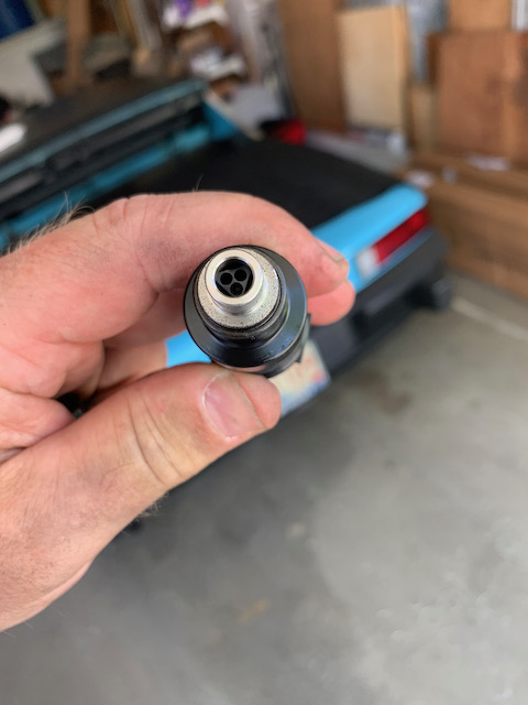

Here are the FJ67's I'm running - 74 2.0 - same stubby appearance but they seem to work great. Stock/standard seals fit as normal.
