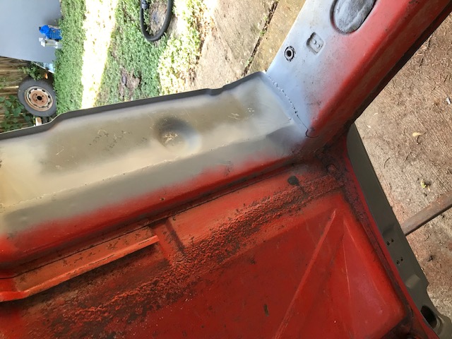

I've been putting this off, but I guess I should document the restoration build for my latest 914. I finally got the car on my property and even though there no garage (YET) I can go ahead and get some things started. This will be my 3rd 914 and it'll be a bit of a second chance for this car, as it has a front end section that's been grafted on (by PO) because of a previous accident - not to mention the rusted away hell-hole and holes in the floor. The graft actually looks pretty well done and solid, and the other items will be addressed. The car came with it's original engine - a 1.7 that's freshly rebuilt with zero miles on the rebuild (uninstalled). I've also got a 2056cc 'GA' motor that'll probably end up in this car.
The car was originally L21E Tangerine and someone's gone over it with a real crappy red paint. Since my last 914(/6) was L21E Tangerine.. I'm going to paint this one something else, and will be doing all bodywork and paint myself.
This "restoration" will be considered a driver quality effort.. but I don't plan on cutting too many corners either. I plan to do a quality job but it won't be going across the block at Christies either. Lots of parts have already been sourced, but there's always more, right! Here's the BEFORE shots:

PS inner firewall repair, completed

Literati914   My longs are generally in good condition on this c...   Aug 10 2021, 09:41 PM
Literati914   Welded up holes from spot welds and the crack unde...   Aug 10 2021, 09:43 PM
Literati914   ..after phospho acid and primer to the inner layer...   Aug 10 2021, 09:44 PM
Literati914   Now to do the driver’s side:   Aug 10 2021, 09:46 PM
Literati914   ..in process:   Aug 10 2021, 09:50 PM
Literati914   I actually finished up just before dark :sawzall:...   Aug 10 2021, 09:57 PM
