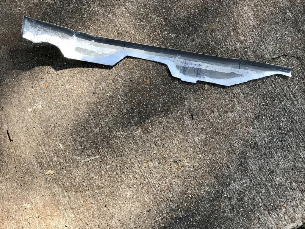

post Aug 24 2021, 08:47 PM
Posts: 2,420
Joined: 16-November 06
From: Dallas, TX
Member No.: 7,222
The outside passengers firewall panel I made up from the remainder of the PS inner firewall:
