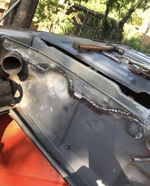

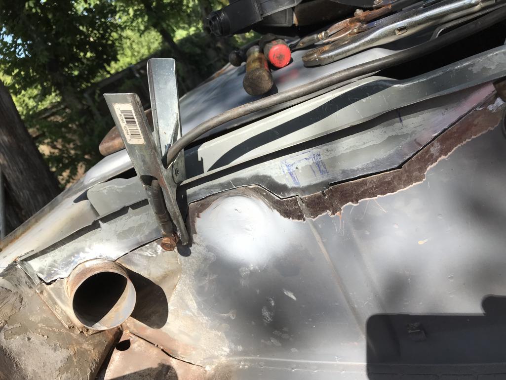

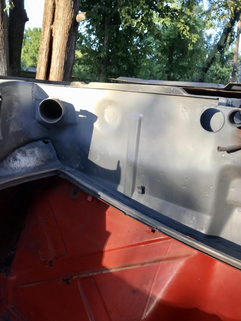

Literati914   Here’s a before shot of the PS inner firewall pa...   Aug 24 2021, 07:24 PM
Literati914   http://www.914world.com/bbs2/uploads_offsite/i.pos...   Aug 24 2021, 07:27 PM
Literati914   PS inner repair in process   Aug 24 2021, 07:55 PM
Literati914   ^ frustrating, when I use the forums 'attach...   Aug 24 2021, 08:20 PM
Literati914   The outside passengers firewall panel I made up fr...   Aug 24 2021, 08:47 PM
