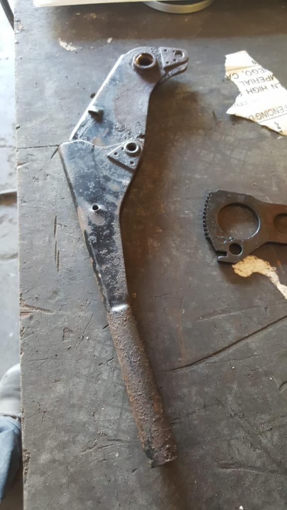

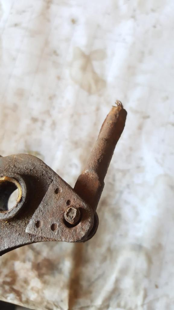

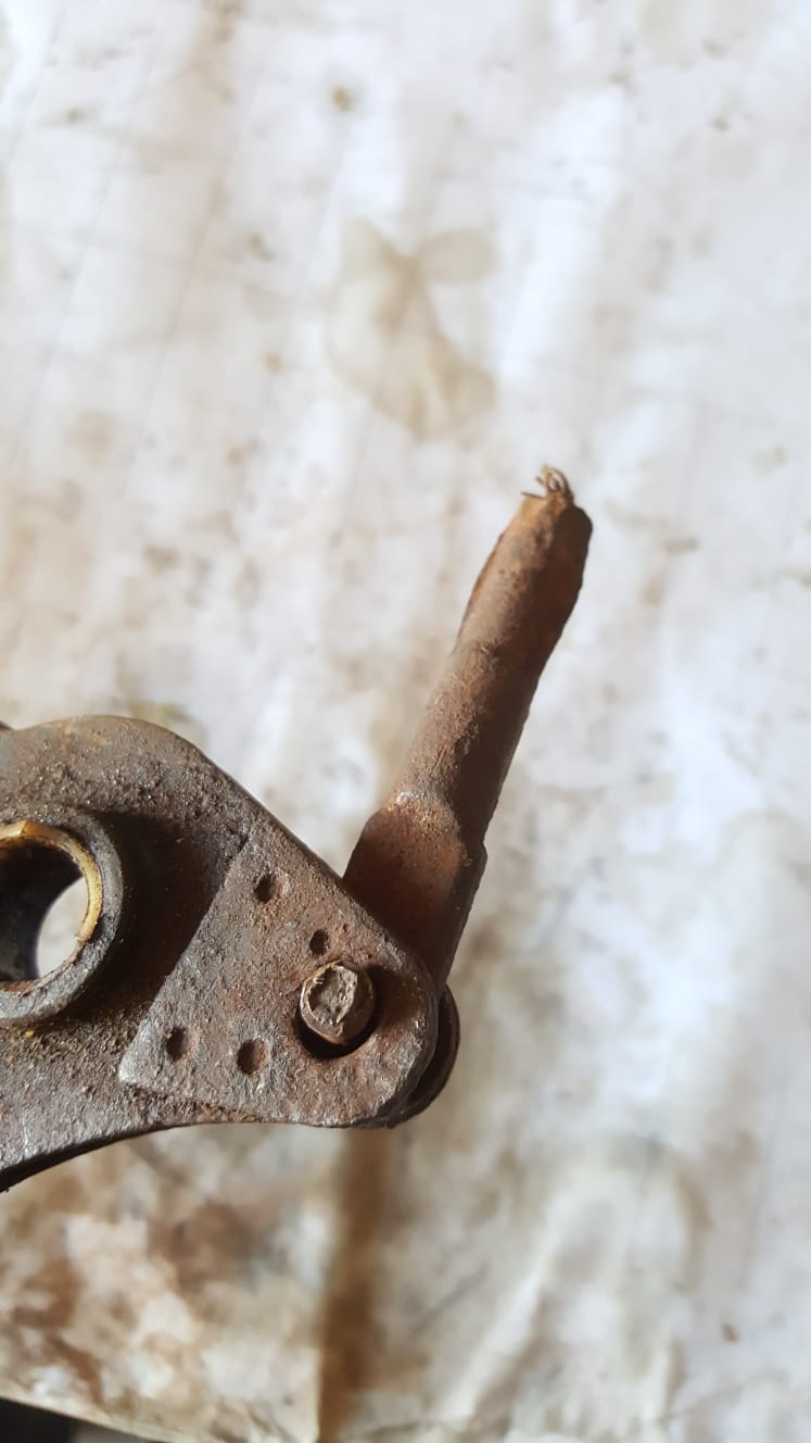

Now that the car is at the body shop, I can concentrate on working on restoring other parts. First up was the handbrake, it was in really bad shape and thanks to parts availability I was able to get it working again.

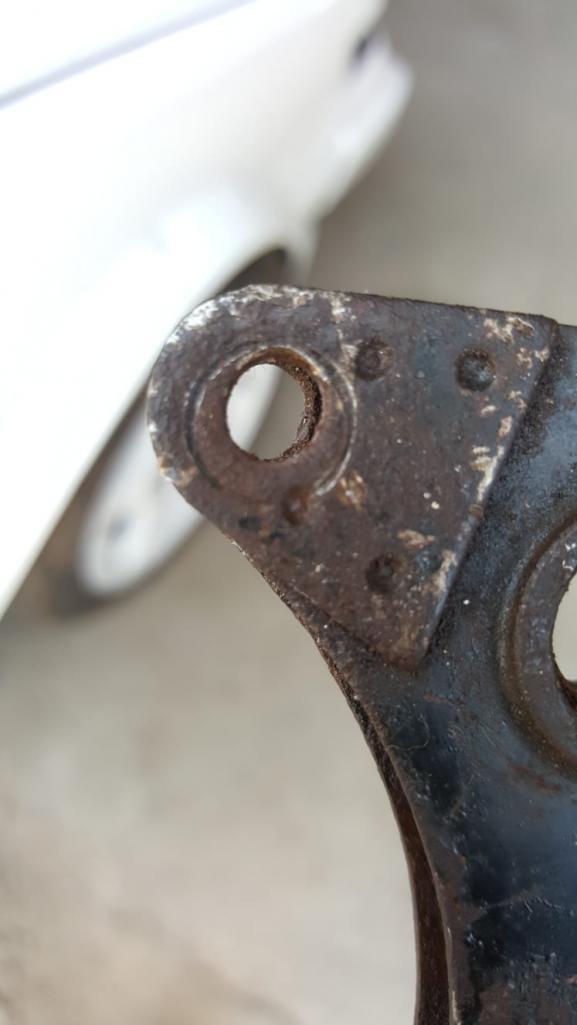

Here is what it looked like when I first removed it from the car. It didn't have the spring, handle or any of the internals.

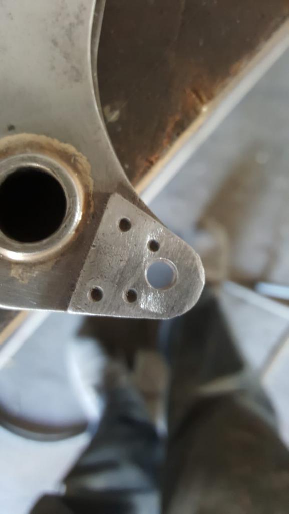

The hole for the cable was deformed so I welded it up and then drilled a new hole
